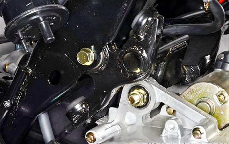

Stig, for the life of me I can’t find the mounting bolts for my scoot, I have the service manual but it shows to mounting prongs and for the life of me I can’t find them, do you have any idea how I get the starter out this thing is driving me crazy. My wife and I moved down here from Panama City because of Michael, my motorcycles and my scooter was the only things not destroyed in the hurricane, now I wish maybe just the scoot would have been swept away lol not really but this thing is a pain in the arss
Any help on getting the darn starter out

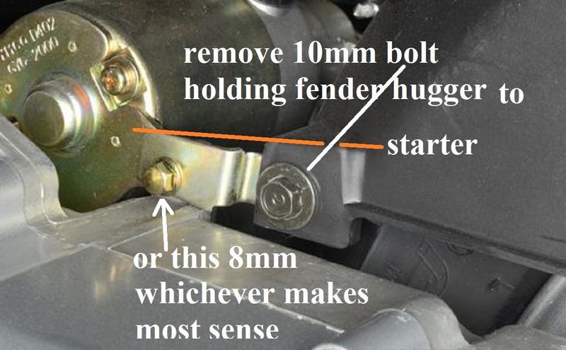

As my Grandpa used to say, "Hold your water!"(though, never really knew what that meant)....I'm pulling my seat/bucket and investigating. There has got to be a way to get at it, without pulling the engine! I'm thinking removing the entire airb0x should expose the two phillips screw heads holding it into the engine.
Have camera, flashlight and coffee....
Back soonest...
Re: KYMCO like 200 keeps dying

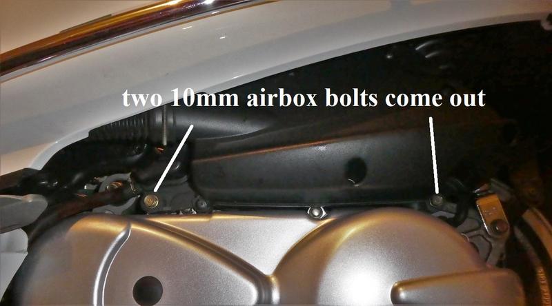

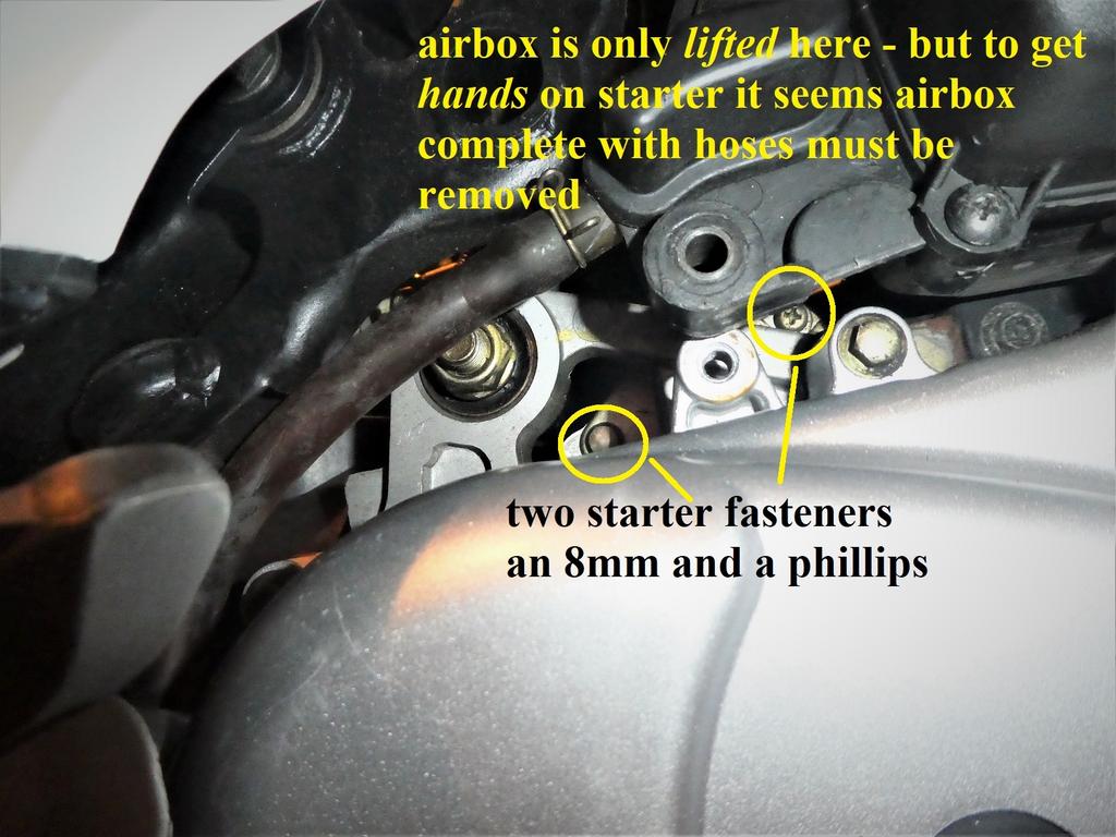

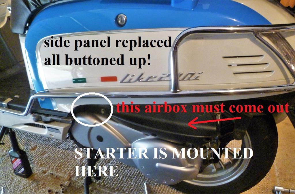

« Reply #68 on: October 13, 2019, 06:07:00 PM »
OK, it looks like the airbox, complete, must come out to access the two starter fasteners. (8mm bolt and a phillips screw)

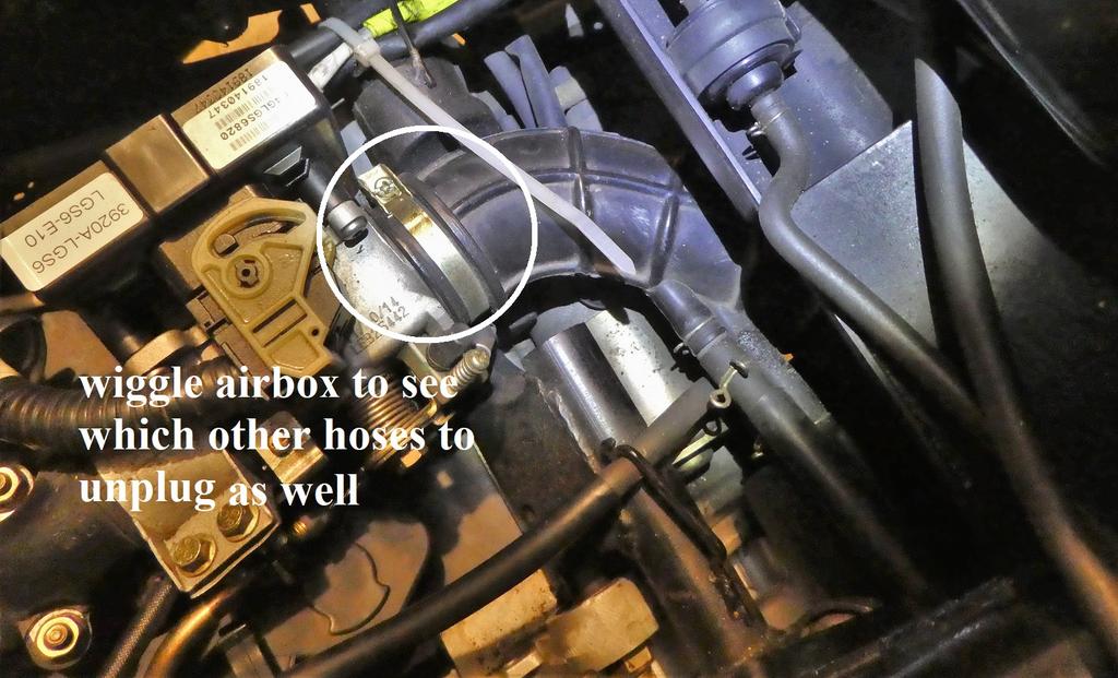

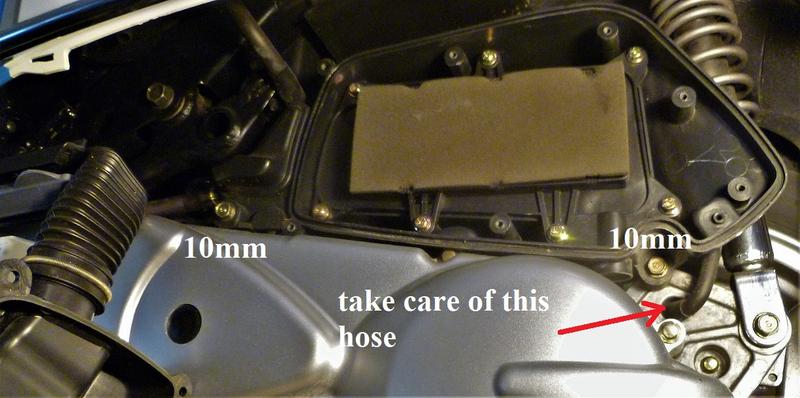

Not all that easy because there are a few hoses attached to the airbox, including the large fitting to the throttle body.
Do take photos, for replacement, and try wiggling the airbox to see what other hoses.tubes need to be unplugged.
With the airbox out of the way, working from the left side, it should be possible to remove the starter bolts, unplug the wire, and lift out the starter.

Ok Stig, I got it out Woopwoop, now finding a starter, I see a lot on amazon and other sites and they look exactly the same but none of them say “ for 200i or 200cc. They all say 150cc but the measurements for the bolt holes are exactly the same. Dumb question, but do you think one of those will work?
I know it’s a blind question but who knows?
