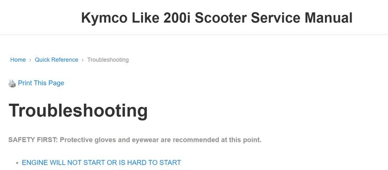

Recommend you go to your www.cyclepedia.com manual, search word 'troubleshooting' - click on "engine will not start...."
See what you find after following the steps....
