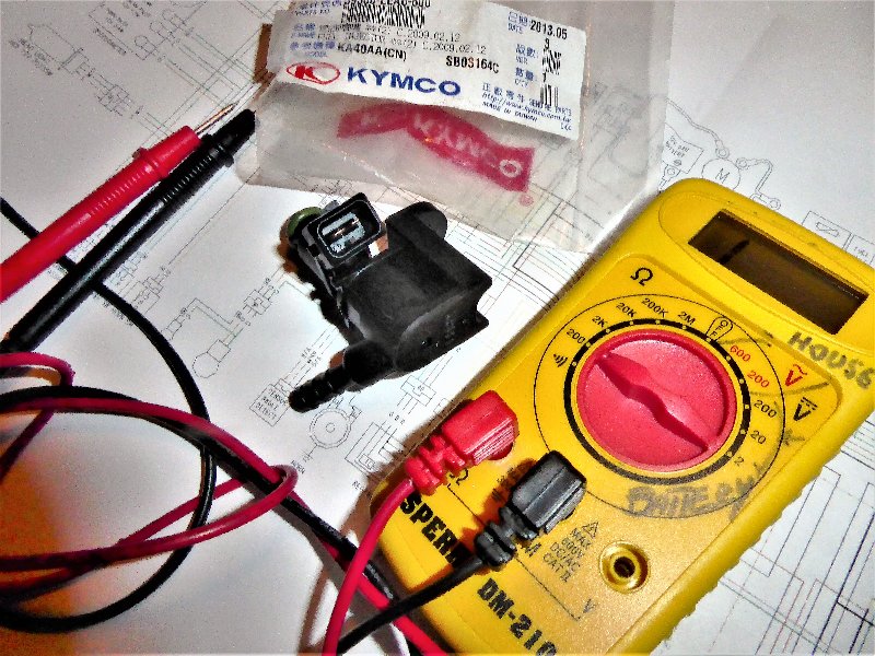

Ok I must have been testing wrong, this time I touched the black probe to a ground and the red probe to the connector, can’t tell which is which but one of the connectors I get 11.9 with the switch on and nothing out of the other. Now on the triggering side when I try and start it, it jumps around but never reaches even 1 volt. So not sure what to think,

Using your multimeter* set to read ohms - measure the resistance between the two injector terminals. You're looking for 11.7 ± 0.6 ?

Ok this is weird, the ohms on this injector kept jumping around anywhere from 32.5 to 145. Even up to 170 something.

Just to eliminate any problems with the meter, what do you get when you touch and hold the meter leads together for 5-to-10 seconds?

When I touch them together I just get 5

I checked two known good LIKE injectors this morning. 12.1 ohms on one and 11.9 ohms on the other (looking for 11.1>12.3 ohms)
Yes, .5 ohms resistance in the meter prongs itself is OK I think.
OK, so back to the test at the injector socket.....still getting crazy readings with meter set to read ohms as in my photo?

Ok finally got a reading and it stopped on 16.4,

The reading you provided us here is outside the range as stated in the USA Kymco service manual.
16.4 is not within the manual's specified range of 11.1 to 12.3 ohms.
The USA Kymco service manual states:
"Replace the fuel injector if the reading is beyond specification."
I am not going to say that you need to replace the injector. What I am going to do is re-read these 7 pages associated with your scooter's issue - and see if it makes sense that a sick injector > and a scooter which now runs only, and only briefly, on starter spray are logically connected.
Hopefully, you'll join me in this as well.....and decide what you want to do.
Your injector is likely a Siemens  DEKA model. A stock Kymco part of @$70.
You get 5 (=as in 5.0)? That means your resistance check  of 16.4 ohms is REALLY 11.4 ohms which is in the normal range. You still have a fuel delivery problem.
