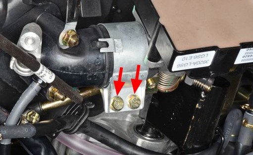

Please check this Ground Wire - we've seen these come loose....
On your newish scooter it should be a gold colored 5mm hex head screw.
If it's loose could bounce upon starting.

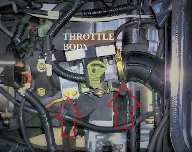

Engine quitting after a start can be caused by air leaks in one of the two boots connected to either end of the throttle body.
Look for looseness of either boot.
Throttle body...
Snorkle from the airfilter...
Intake manifold clamps...

I tried eveything except that little ground wire in the pic, I will get at it later today and let you know, also I do not have a extra battery, I may just have to buy one regardless, like I said it is a 2013 but only has 500 miles, but has always had a tender attached to the battery when not in use. So we will see.
