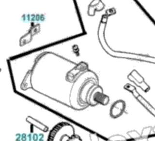

Re: KYMCO like 200 keeps dying
« Reply #57 on: September 29, 2019, 07:43:52 PM »
To answer your question, nope. No step by step.
A 3 min. test before trying to remove the starter:
You have a good brake light with key on and brake lever pulled?
Your turn signals are bright and blink at normal speed with key on?
Stater relay 'clicks' when start button pushed?
Yes?
No? stop - and please report back.
I have never really looked...but hopefully you can see the two 8mm mounting bolts after you remove the seat pan?
I think it is the gold colored can-shaped part nearly under the left side of the fuel tank?
Or, maybe you can get at them from the left side of the scooter, under the bodywork? But I'm not seeing a clear path that way.
If you can get a socket or wrench on the two little bolts ---- it should slide out after being unbolted.
I think the fender hugger is also attached to the rear-most mounting bolt.
New OEM Kymco one runs about $70. Probably a bunch of cheaper Chinese ones avail., if you want to go that way. But, since there's no kick start on these scoots - you might want to invest in a good one.
You, and we, will be pleasantly surprised if a new starter will fix your original issue!
