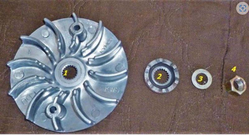

Well, I went to take the scooter on a speed run early this morning before traffic.  Started right up, revved up, creeped out to the street but when I tried to take off, it bucked, stumbled and died....Tried it again, same thing.  As soon as you put a load on it it stumbles and dies.  Now, this is just after I took the cvt apart, checked it all and put back together. I also adjusted the valves and put in an iridium plug.
I noticed my variator backing plate seemed to be rubbing on the step in the crankshaft.  Is there supposed to be a washer or ship there?  I looked at all the parts diagrams and didn't see one shown.  When variator is installed, should the back part of the variator turn freely?  Mine seems to be solid.  I would think it had to be in order to turn with the crankshaft and throw the rollers out.  I'm sure I put it back together the same way it was when I got the scooter.  I've done this job several times on a variety of scooters.
I have know idea if this is related to my valve/plug work or my variator work.  I'm frustrated but I've been there before. Step back, take a break for a day or so and then I'll figure it out....maybe.

The whole CVTs variator has to move freely and frictionless on its boss.
There a variations which have a shim behind its CVT, and I think the 200i does have.

Pls see
https://www.kymcoforum.com/index.php?topic=28850.0
There are No shims or washers with-in the LIKE200i's assembled variator.  The only washer is as seen for final fixing of the nut .....see photo of the order & arrangement of these parts.
Possible causes of CVT trouble after a servicing:
sliders fell into wrong position when installing
that front nut torqued/tightened on the 'belt' by mistake. Pinched the belt....nut not tight. Variator not locked to shaft - damage to splines will come - scraping on inside belt cover from nut working off. Loss of 'drive' to wheel.
Rubbing on shaft step - photos possible?
Did the CVT falter - and stop the engine?
« Last Edit: August 27, 2023, 03:54:54 PM by Stig / Major Tom »

Very clear reply there Stig, thanks.  Photo particularly helpful.

thanks guys but two different answers sort of.  The backing plate, part 22131, is steel and fits over the crankshaft with a hole that is crankshaft size and the boss, rear variator, rollers, etc fit over the boss and move easily.  Its the backing plate, part 22131 that shows wear on it's back side where it rides on the step in the crankshaft.  It would appear that the boss puts pressure on this backing plate 22131 against the step in the crankshaft when everything is assembled and tightened up otherwise how would the weights get flung outward.
That said, I did put the variator on wrong when I changed the belt and rollers the first time a few days ago.  After a short ride I heard a sound from the cvt area and investigated resulting in yesterday's going back in to check.  The whole variator rocked back and forth a small amount.  Apparently I didn't get part 28211 on properly and when I tightened down the nut I guess I jammed it down on the splines.  Was a bear getting it and the drive face off.  Took a little file work to straighten everything back up.  That's when I noticed the unusual wear on part 22131.  Everything went back on fine and ran like it should but I didn't ride it waiting on this morning and low traffic for a speed run.
It's too hot in my shop to work during the day here in Florida.  I did take the seat bucket out to do the work yesterday and wonder if it's possible that I pinched the fuel line when reassembling.  Wishful thinking I'm sure but the scoot starts, idles, and revs up just fine.  It's when you sit on it and take off, it stumbles and dies like it's not getting fuel or spark.  We've got a minor hurricane coming this week so I'll probably have lots of shop time.   Thanks to you guys for messing with me.

Like I wrote there are variants which have shims onto its crankshaft, to be seen as parts #22110 in this diagram.
