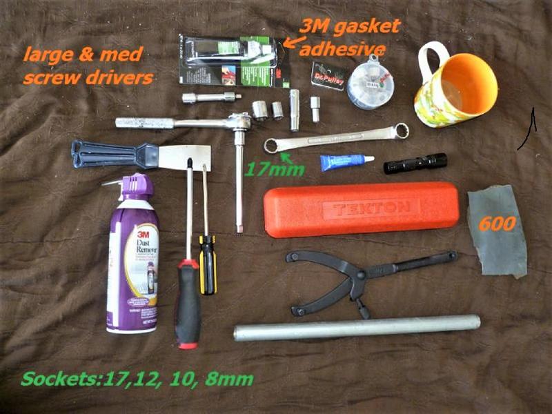

Tools I used

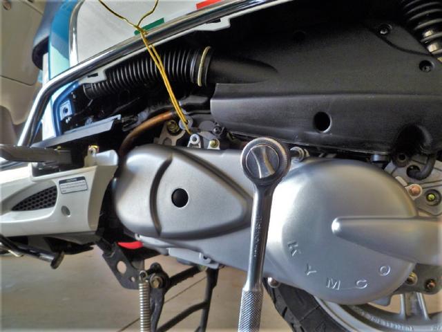

Then remove two screws holding the airfilter in place. Lift and tie it out of the way if possible.

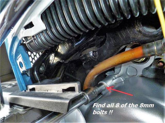

Remove the eight 8mm bolts holding the belt cover in place. If it is stuck, tap with a rubber or wooden mallet, or come at the pry point through the wheel spokes from the muffler side. Be a gentle as possible! But it is often stuck pretty well. That is the forward pry tab just to the R of the arrow head.

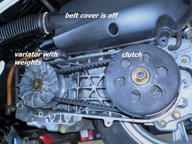

I cleaned the old gasket material from the cover, and finished with some sandpaper. Use a soft paint brush to clean ALL of the blackish dust from inside the belt cover!

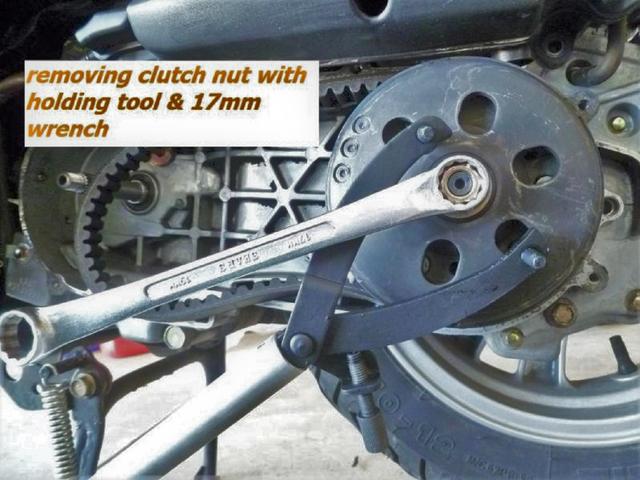

Left loosie! Using $12 holding tool from ebay.
Some owners lightly sand the surface of the clutch pads. Most clean the inside of the clutch bell. If your CVT is operating smoothly - you might just leave well enough alone.
8 bolts hold the belt cover on, and 2 screws for the airlifter, then slip the side panel on and fasten screws and bolt.

Again, your documentation is awesome. Does the like 200 not have sufficient room to slip the belt over the clutch and then the drive pulley? I have never pulled my clutch and probably should at some point to clean it out.
Don't know that I've ever tried - while I'm in there I always want to clean out everything and look at seals, buff the pads, etc.

... Does the like 200 not have sufficient room to slip the belt over the clutch and then the drive pulley? ...
Coming here to say that, yes, you can get a belt off and on without pulling the clutch, but it's a tight fit between the clutch and the edge of the cavity. You need to worry it out/in, turning the clutch by hand as you go. BTDT (I had no desire to open the clutch when I recently had to replace the roller weights.)
Good to know, thanks.
But, with my impact gun, just as easy to remove that  nut....and then do some quick therapy on the bell and pads. "Therapy"...but probably just for my psyche🙃
