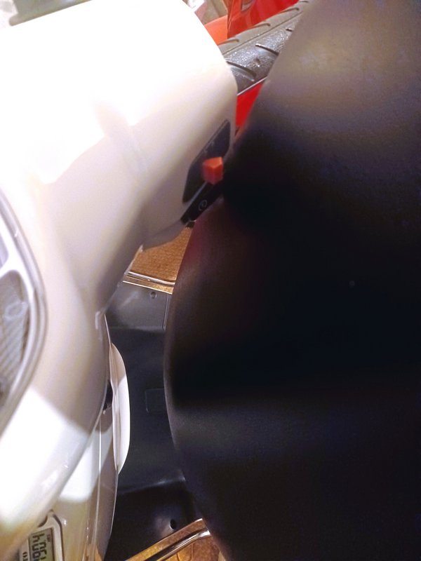

OK Stig, I'll ask.  How can opening the seat affect the kill switch??  I had a Lance PCH125 and did a bunch of work on it.  Couldn't get it to start.  Spent 2-3 hours going back over everything, no bueno.  I realized I had disconnected a wire that went from the seat to a connector.  Put it back together and started right up....I like working on these guys but they can be very frustrating at times.
Re: new to me 2012 Like 200i in Tampa, FL
« Reply #50 on: September 09, 2023, 05:18:58 PM »
On my LIKE the open seat can come in contact with and flip the Kill Switch.
But then again, the stock seat was removed years ago - maybe the stock seat can't hit the switch?
Speaking of the LIKE seat - being a fellow big-fellow, I'm surprised you can tolerate the stock seat ~! I could not go more than about 20mins on it! I bought a LIKE seat from a crashed 50 on ebay - and spent a few days making my own. Truly a thing of ugliness - but sooo comfortable - raising my seat height probably 4" so that at 6'3"+ - I can flatfoot at stops now.

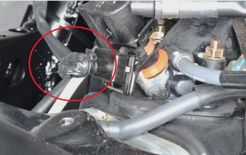

been looking at the engine and noticed the fuel injector wiring has electrical tape and a zip tie right where the wiring goes into the injector.  It doesn't appear to be something the factory would do.  Is it possible the injector has been changed with only 616 miles on it when I bought it??
To check spray on the injector, do I just pull it out and crank the bike with injector pointed into a container?
Can an injector be cleaned by a shade tree mechanic like me?
Is there a substitute injector off ebay?  If not where is best place to source a Kymco injector?
I get discouraged since problems seem to be cropping up everywhere.  For example, yesterday after I swapped the weak sparking iridium plug for the original sooty plug, it started right up. Started later in the day and it ran poorly, missing, etc.  Same thing this morning when I started it.  After revving a few times and holding the throttle open for a few seconds, it settled down to a reasonable idle.  I went and bought a new ngk cr7hsa plug and installed it.  Started and idled pretty good.  That's where it sits right now.

As for your injector.....no one has messed with it..
 Factory photo......
I cannot explain those MPH's you are missing (now down to @3>5mph)....but I think your scooter is good to go, now.....and may have been after that first tank of new gas and a valve check! No one should be claiming to the public that this is a 65mph scooter.
