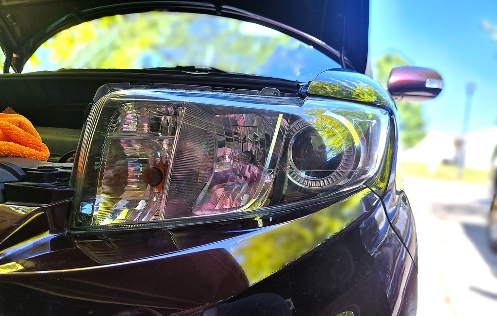

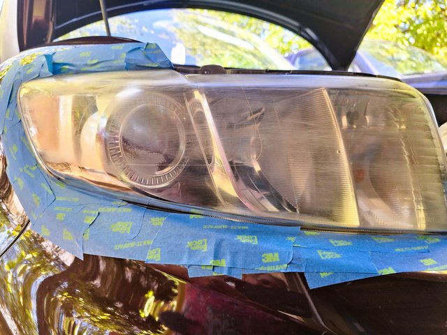

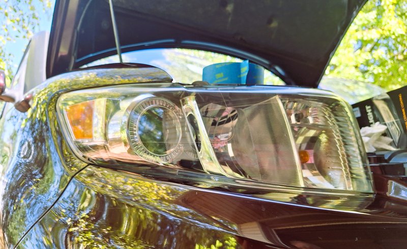

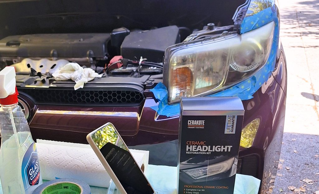

Daughter c/o poor headlights on her car.
This product cleared the clouded plastic covers on xB.
Pretty simple to use. $17 Home Depot.
Tape, wipe 4X each headlight. Hand wet/sand 3 mins X 2. Wash, dry. Apply sealer.
My daughter was impressed - she says usually when I head out the garage to "launch a missile, or something".....there are problems.
True enough.
But, not this time.
Would this work to clear a scooter screen? Or are they a different kind of plastic?

Thanks for that Ruffus!
Yeah - all kinds of kits, and home recipes out there (8 grades of sandpaper, then Clam chowder, etc.)  for clearing headlights -
As you can see - follow simple directions and this stuff works. Enough in the box to do 4 headlights, easy. How long will it last? Who knows - dealer installed new headlights quote @$1,000.00 - but they weren't certain. No one has ever had it done!
@$250.00 for a pr of Chinese parts - and sure, Toyota sources theirs from China, too - but they vet that company for quality.
Some work to install them....so tried this first.
I recon it is the sun causing most of the damage??
(my Night-Rider Scoots should last a long time :)

And, I bought Cerakote after some 'tubes.
