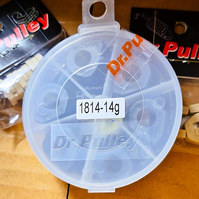

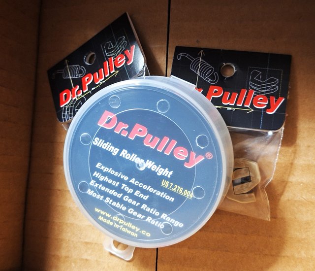

Received the Dr Pulley slide weights and slide pieces six days after placing my order with Buggy Parts NW
The LIKE200i uses six weights and 3 slide pieces - BPNW tossed in a second bag of slide pcs by mistake.
Years ago the youtube for these Dr P's listed BPNW as their American distributor - so although they are widely sold these days - I've been buying from BPNW to insure I'm not getting knock-offs.
It's been a few years since I've ordered any new sliders - these are a different color these days.
BTW: I've never had a problem with Dr P's flipping over during operation.
I put in my first set 10 yrs ago - 11 months after purchasing the scooter.

Stig, what made you go w 14 g (higher than the stock of 13 g I believe)?

Sorry monkey-b,
I'd be fibbing if I said I remembered why I first went to 14g.
I know that years ago I tried some that caused my revs to be too high when cruising at 35mph. Sure, they gave me more acceleration - but at the cost of a busy engine.
