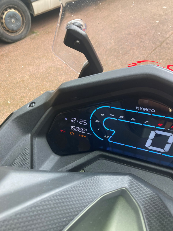

Bit of a shock when I checked the mileage since last oil change, I knew I'd run over, but this much?...
