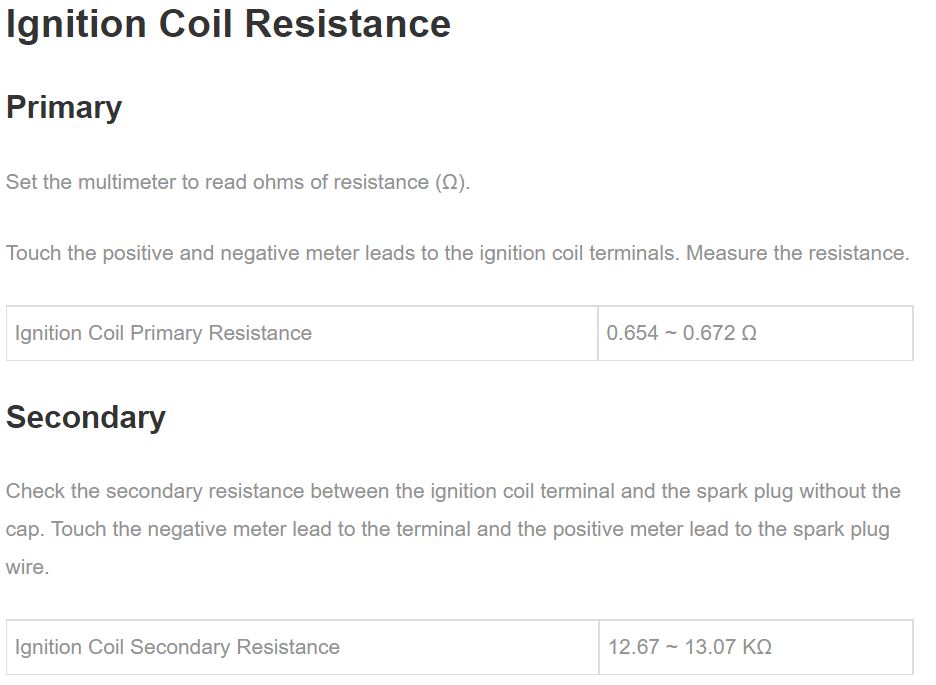

And the coil? With the multi-meter.

Terminal resistance seemed to jump around from .6 to .8. Resistance from the spark plug wire end jumped around as well. Seemed to settle at 13.5
