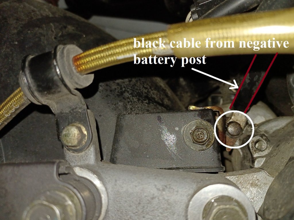

I like Neil's suggestion about the ground wire.
The negative battery cable is attached along the R side of the engine. You can see it below the rear brake line, here...
Check if it is snug?....if too hard to remove and clean, try loosening it then retightening it. An old electrician showed me that trick with hard to reach terminals. Often it restores current flow.

Please do look at the ground point for the negative cable-to-frame (photo above) . Has it vibrated loose, or is the wire broken?

Red Kill switch was in the run postion. Yes. i checked all the fuses that were near the battery. I saw 2 and both were fine when i checked them with my multimeter. Headlight is on with the key. Fuel pump does turn on, and Brake light does go off when grasping the brake lever. Good amount of oil as i had just changed it a few hundred before this, still looked fresh when i pulled it this morning. Cable is in good condition just as in the photo above.
