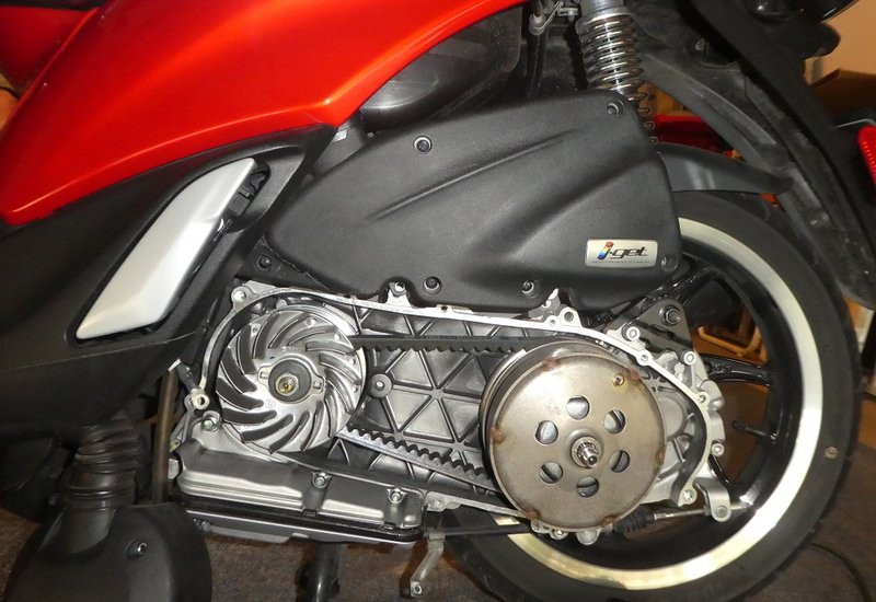

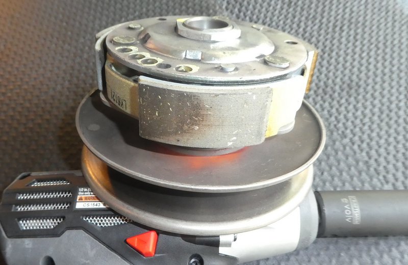

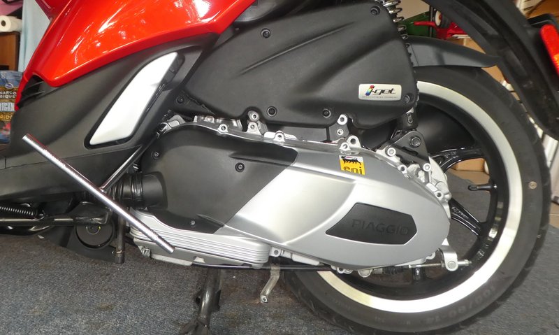

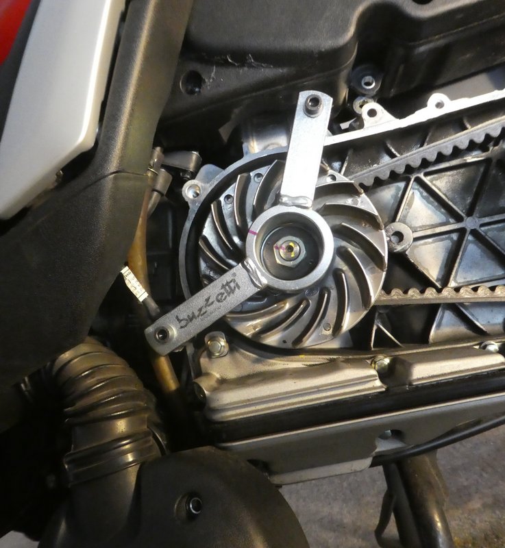

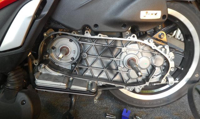

 I figured that while everything was taken apart, I would clean out the engine area and variator/ clutch. I put everything back together this morning. I washed and waxed it until it sparkled. I rode it for almost 40 miles without a hitch. Knock on Chinese plastic, everything looks good.
 At this point , it looks good. Thank you all for the help.
