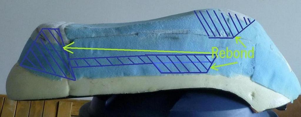

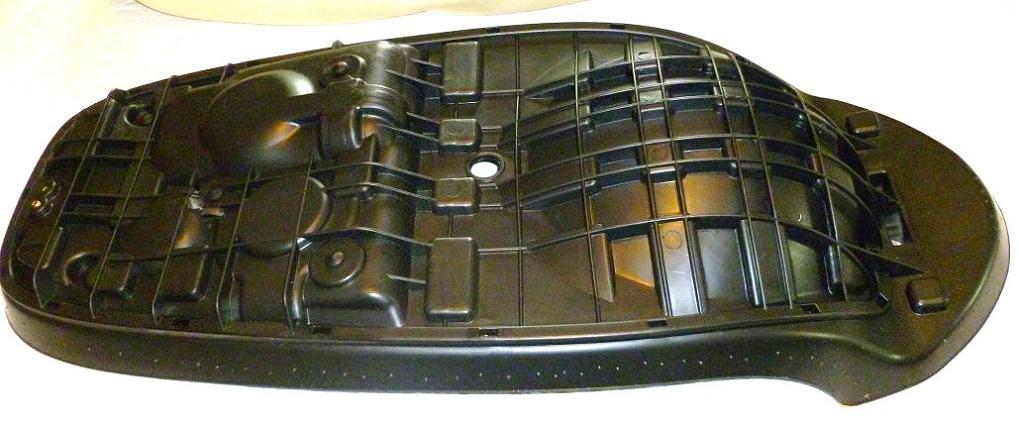

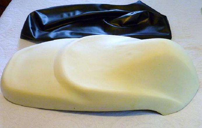

BTW - here's the LIKE seat pan (50 and 200i models)
Stock foam seat pad with cover removed.....
It's not pretty - but it is very comfy. Wider, thicker, kept the up-sloped front to prevent sliding forward in hard stops. Various types of foam used.
I used firm green rebond foam in the blue hatched areas  - under the soft skin of blue foam - all of it is glued over the original seat foam.
Then stretched Sailrite 4-Way Stretch vinyl cover over the foam - and used stainless staples.
It is NO longer possible to feel the ridge in the middle of the seat pan.
Probably wouldn't work too well for riders less than my 6'3" - I love it!
