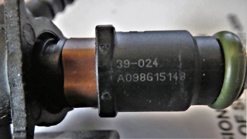

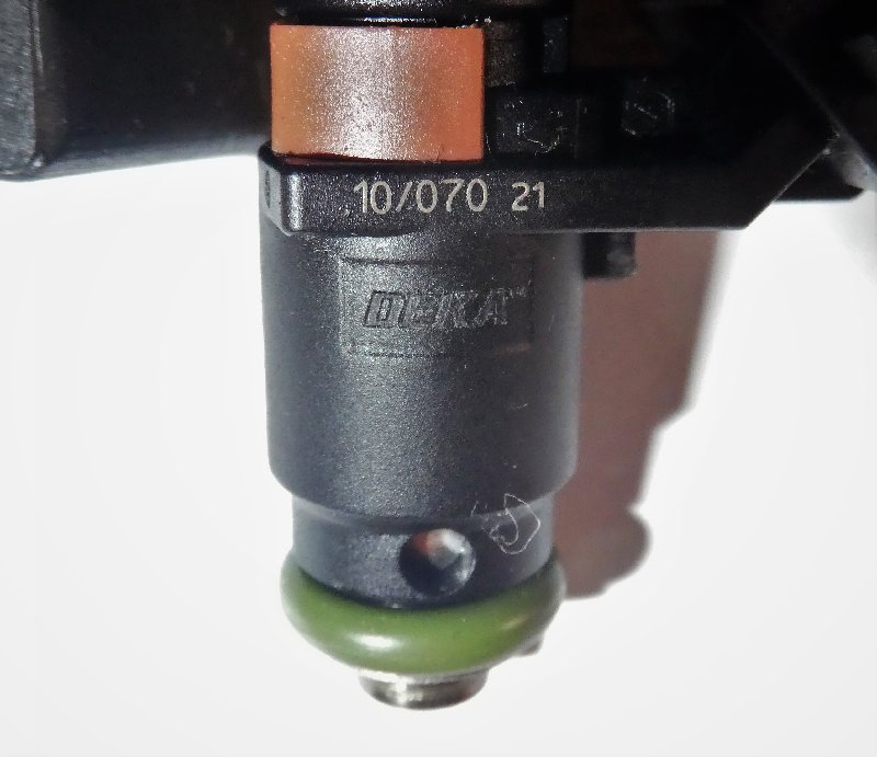

Ok I’m gonna get a fuel injector, on my fuel injector there are sever numbers
12/145 06
39-024
And another number that partially rubbed off
C185N03 then it’s scratched out maybe a 0 amd then 1 but can’t tell

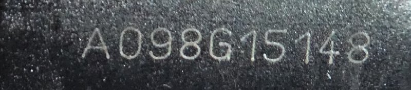

Just like in the vacuum tube days, all the vital identifying information is the first to disappear! I suspect the Kymco part number was on the bag or box that injector was in at the factory and all the inscriptions you see are from the guy who actually made the injector. Injectors seem like spark plugs with different reach, heat, thread diameter, etc. but there is one exact plug that goes in YOUR engine. Kymco part in the Kymco bag with the right part number is IT initially. Substitution later.
Re: KYMCO like 200 keeps dying
« Reply #158 on: April 19, 2020, 03:18:20 PM »
OEM KYMCO parts bag for LIKE200i  injector
D E K A
Better look at those bottom numbers:
« Last Edit: April 19, 2020, 03:35:21 PM by Stig »
