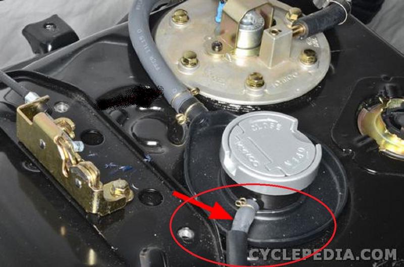

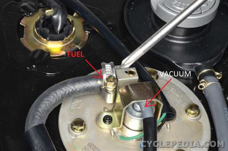

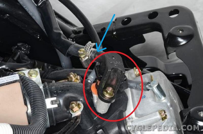

Possible sites for fuel leak....
INJECTOR
VACUUM LINE AND FUEL LINE
BREATHER LINE
Or the cap itself, or around that 6-bolt fuel pump lid.....or the fuel line or weld seam of the tank?
Fuel smell and leak is a puzzle to me, if it is not due to the heat and fuel being forced out by expansion.

Stig - checked out all those locations and no fuel noted, but obviously with it not starting currently i'm gonna want to look again for leaks in those spots once i am able to finally start it. I'm bookmarking those photos. It doesn't sound from what you are saying that fuel smell/issue is causing the non-start (or the stall i experienced at stop light). Considering i was doing a comfortable 45 mph and felt no problems with acceleration, odd noise, etc just before i got to the stop light i'm thinking electrical for the stall/non-start issue.
