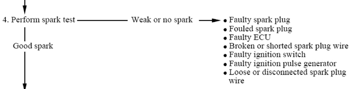

So,  a good blue spark when you hold the current plug grounded to the frame....if not, try a new plug. ??
Then, with luck -- it is the spark plug, connections, or plug wire, or coil.

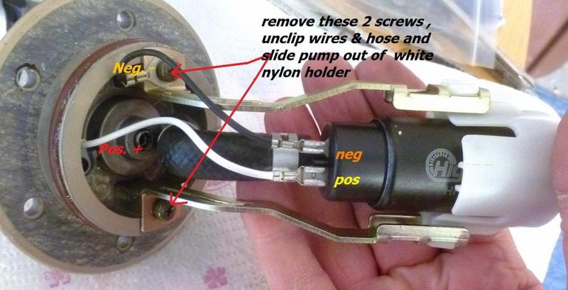

PROBLEM SOLVED!!!!
well Okhams razor was in full effect here. Had a day off so finally got around to pulling out the fuel pump to take a look (didn't want to start it previously and then walk away). Low and behold after getting it out I saw the following problem in the picture attached with the fuel line from the pump motor....
Explained it all in retrospect and why i never saw leaking fuel... It all leaked back into the tank apparently. Anyway replaced the 5/8 inch fuel line from Auto zone for 2 bucks and it started like a champ and is running great. The only reason I can ascertain for the line splitting like that was the previous owner keeping it outside in the heat with a non filled tank. The line just dried out and was cracking until it eventually gave way.
Anyway I learned a lot about my kymco in this process and thank you all for your help here. This forum is awesome.

« Reply #28 on: November 02, 2018, 06:05:48 PM »
So, you're talking this heavy black hose, seen here?
Well, I'll be danged!
No way that was going to be easy to diagnose!
Well done you!
(Wouldn't have thought to replace that hose when I was in there on my year old scooter.)
« Last Edit: November 02, 2018, 06:10:40 PM by Stig »
Azmark7
  • Posts: 16
Re: Like 200i won't start after stalling
« Reply #29 on: November 03, 2018, 01:07:31 AM »
Yes indeed that was the hose that split. Honestly wasn't looking for it either, I simply took the fuel pump out and noticed it immediately and deduced that wasnt right... Lucky I guess in this case. Anyway, I'm back riding again!
