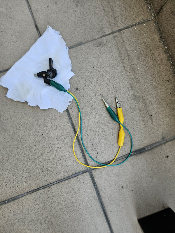

Today I removed fuel injector for cleaning. I made test bench using 12 V battery , syringe and tire valve ( idea came from here :https://www.youtube.com/watch?v=HnDCbWWNjA0 ) Spray pattern was good from first shots. I used about 50 ml of carburetor / egr cleaning agent. I put two new orings as per manual and I went for a test drive and noticed no change  8)
I swapped ECU's, from 2011 V2 model to 2009 V1 model. To my surprise I found the same Kymco P/N already installed  :o but Keihin P/N was different. Still, I deceiced to give it a go.  So far I got rid of middle range part throttle engine hesitation or "micro-pulls" which I have been experiencing for last 3000 km since owning the scoot. I will post full swap review after about 1000 km with "new-old" ECU.

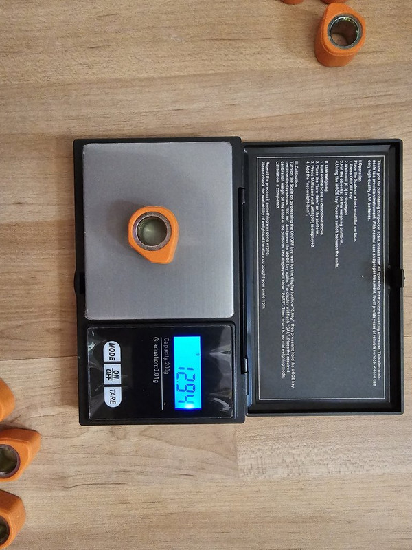

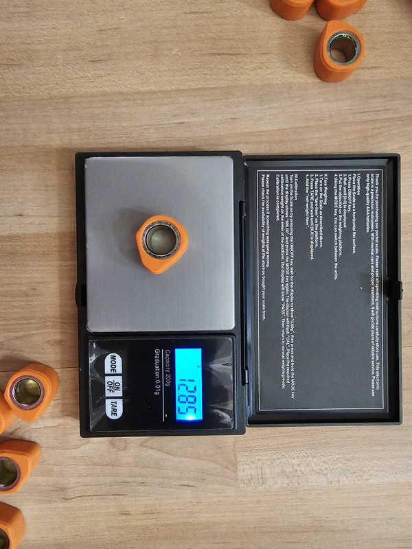

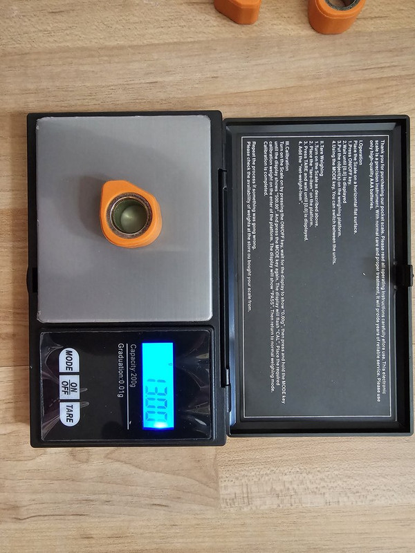

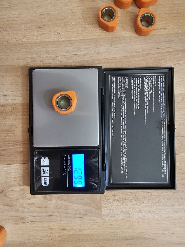

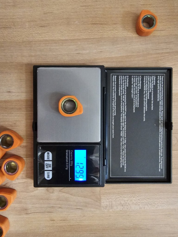

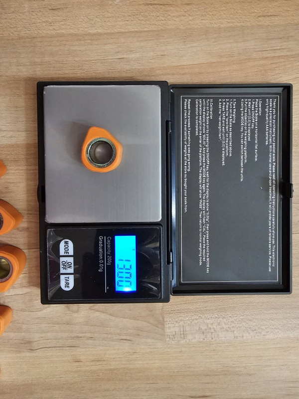

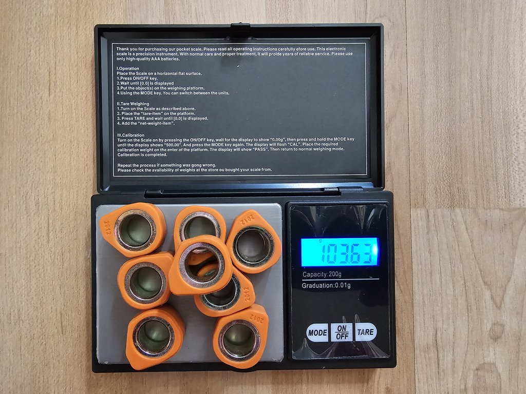

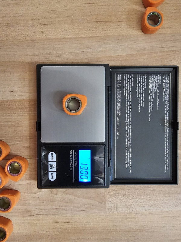

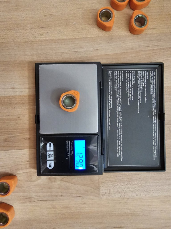

Today I had put chinese 20x12 13g sliders from Aliexpress. Weight is quite close to specs. They will set you back 16 USD.
I had 13.5g 20x12 rollers for last 2000 kms but as milage passes they seem to starting to get "lazy" - I mean that after putting them new I could rev engine WOT to about 7000 rpm but after 2000 km peak RPM's go down to about 5800 rpm. There is some wear but it's even and tehre are no flat spots.
I will report back after 1500 km how these chinese sliders perform.
