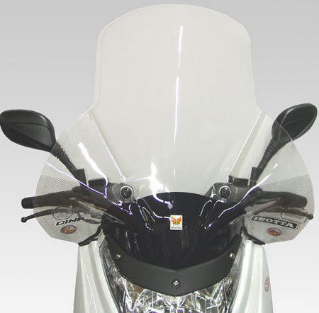

I made my own windshield for my Yager today. It's made from my original shield off of my old 400 Burgman scooter. I had to trim away on all four sides to get it down to fit. It must be pretty aerodynamic because it didn't take any thing away from top speed, 72mph. I was able to make use of the hardware from my unused Isotta windshield. Good body and face protection. What do you think of it?

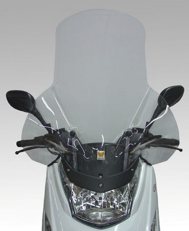

2 more pics that I couldn't fit on one post.

Now that's a windscreen I'd be willing to pay for. Very good looking.
How's it hold up in the wind, any flexing? Does it keep the wind off you at speed?

It works far better than I ever expected. It's 3mm thick so it's pretty rigid. Certainly no worse than the Isotta windshield. Mileage seems the same as with the small original shield and it looks pretty much like it was OEM to anyone who does't own a Yager.

Really NICE job for a windscreen on a great scoot!
