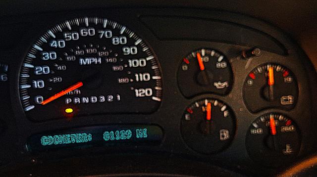

Ta=Daa!
Look at that temp gauge! Not sure I've ever seen it go up there since Pops gave it to me. Just figured it's a cool running engine.??

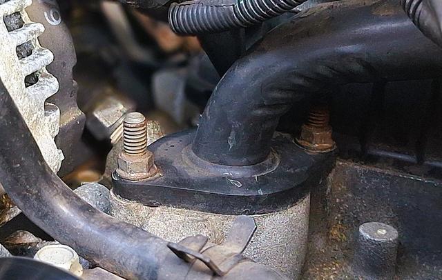

I shot the thermostat hardware for 3 days with PB blaster - figuring, me, I'd snap the stud off (after 20 years!)
Pic does show a different front stud and nut.

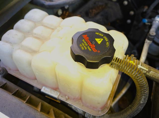

New exp.tnk cap.
