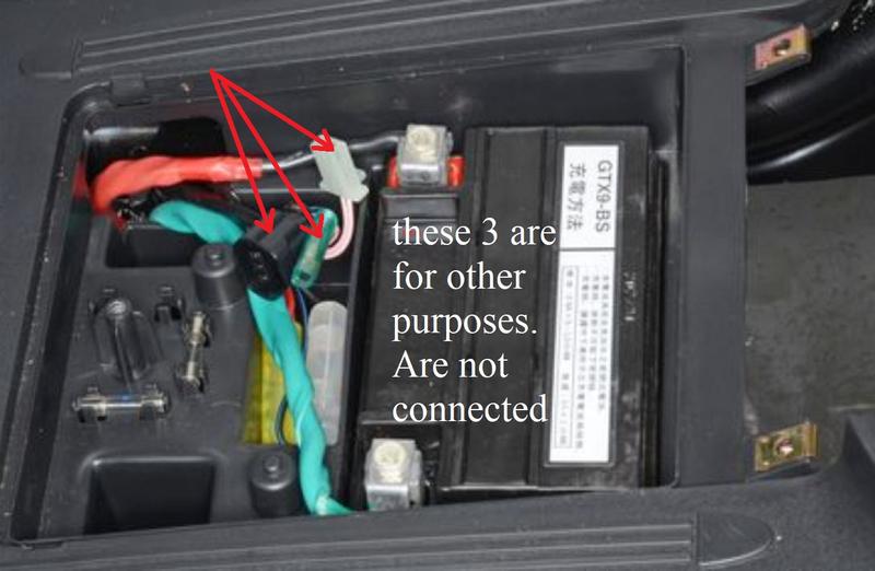

Hey guys I just got a like200i and rats chewed through the wires. Now I’m trying to get it running after reconnecting all the wires. I have two questions.
Question one: there are three connectors next to the battery location. One black three prong, one clear two prong and one green single prong. What are these for? They were not connected to anything.
Question two. There are two sets of brown and green wires up in front of the bike near the ignition. Are these two separate wires or do they go together? I’ll include pics. They seem to be a slightly different color so I’m curious where they were supposed to go.

These three wires are not connected. They are test connections of one kind or another. You would not need to connect any of these 3 to get your LIKE200i running.
Keep us posted.
Good luck!
