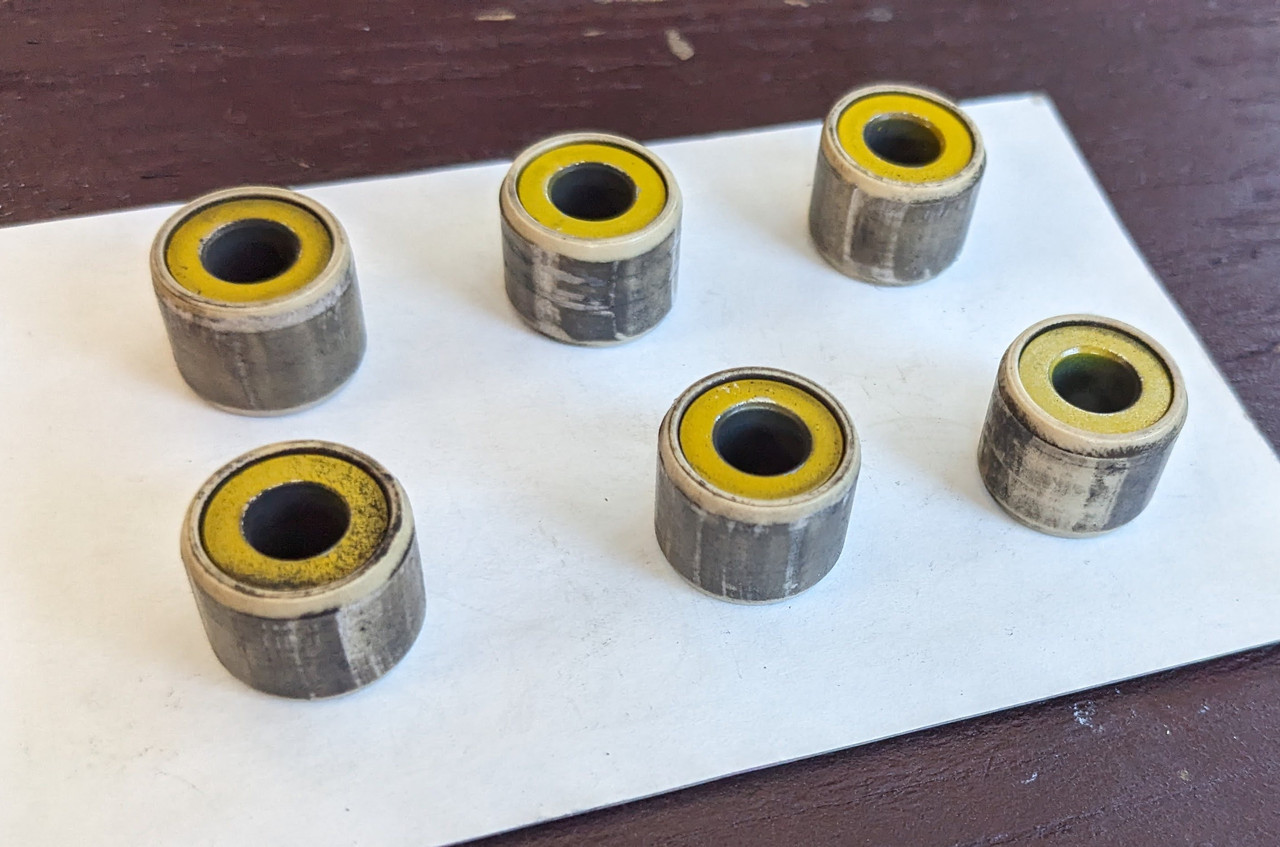

Lately my scoot has been rough off the starting line, with the clutch grabbing somewhat violently a couple of times before getting moving. Worse at low rpm; I had to grab a handful to get going without drama. The best way I can describe the feel was like being in the car with a teenager learning to drive a stick. I mentioned this to a buddy who used to own a Vespa dealership and he told me my roller weights had flat spots. He also told me that as long as I was replacing the weights I should put a new belt on.
Today I spent a good three hours wrestling with the tupperware and the fasteners around the air filter and the drive case. Splitting the case involved a mallet and a pry bar as the gasket had fused to both sides of the case. And once inside I needed a decent impact driver to remove the variator nut.
Sure enough, the rollers had assymetric wear, aka "flat spots." Visible but subtle in appearance, but immediately evident when rolling them on a flat surface.

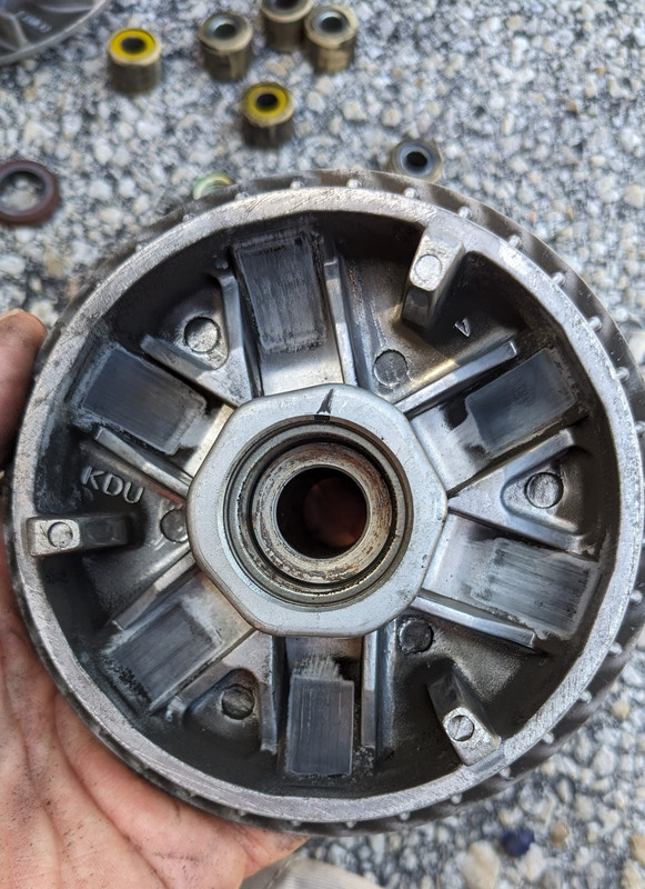

The ramps on the inside of the variator had corresponding wear marks showing the weights had been sliding in places and not rolling.

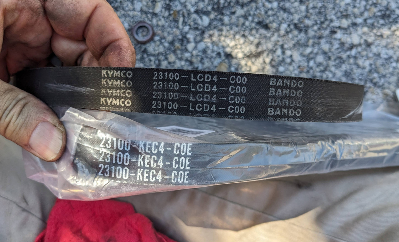

As suggested, I also replaced the belt, which hardly looked worn. Slightly different part number, with the difference being, I think, some Kevlar.

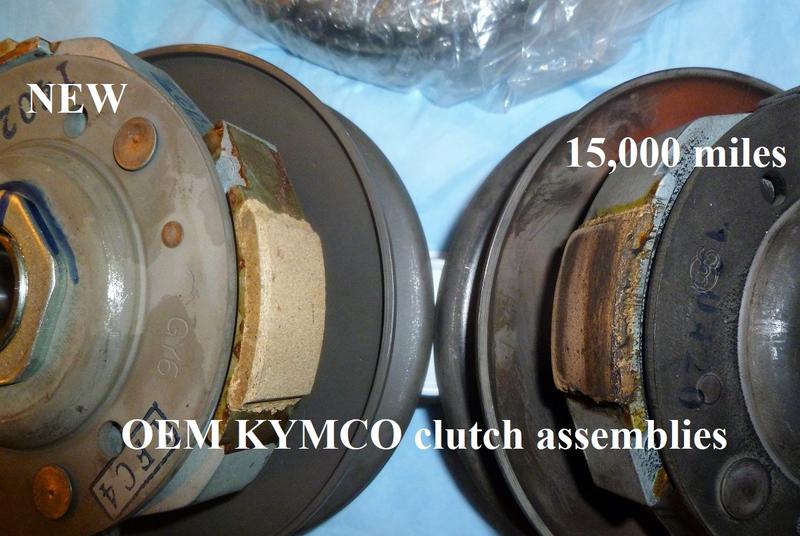

I found that my jerky/grabbing move away from stops was caused by glazed clutch pads....and by my riding style!
I'm a guy with a life-long habit of NOT abusing my machinery. Cars, scooters, ,,,braking, stopping, accelerating. Boring as H....but that's me.
I was informed by various veteran scooter riders that one must make 'brisk' pull-aways from stops on a scooter. Anything approaching a gentle, feathered approach to getting underway again will slip the clutch enough to cause it to glaze. Then, you get the nasty jerking starts.
Old hands say to hold the brakes and rev the engine to remove the glaze. Against my nature - plus it always came back!
So now I just lightly sand the clutch pads and use a different riding technique.
Now I am not a teen on the throttle when moving off - but I do shoot for brisk throttle and it's been working on my LIKE for a decade now. Just a thought.

my first thought after reading this was glazed clutch pads and clutch bell...or likely a combination of rollers and clutch glaze. Anytime the cvt cover is off is a good time to open up the clutch and see if it needs a little sanding/deglazing, along with the  clutch bell.

This sounds like routine maintenance.  I normally replace the clutch drum and linings, and the variator weights, at the same time at about 15,000km.  They're not expensive.  This makes it like new again!
« Last Edit: March 10, 2026, 04:02:38 AM by JJJoseph »
Re: Roller weights and belt replacement to fix "clutch grabbiness" issue
« Reply #7 on: March 11, 2026, 01:33:59 AM »
Clutch assembly,  only way sold for a Like, is @$120.
Should last 15+ thousand miles. Bell for my LIKE renewed with just greeny scrub and a cleaning.
