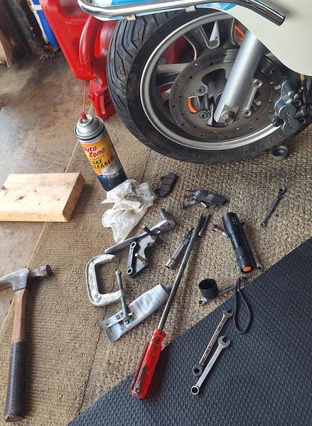

60 °F today - ladies are gone for a few days - plenty of garage space - so I'd run out of excuses for tackling my locked front brake on my 14 yr old LIKE200iLX.
I'm no expert on brakes, (cars or scooters) - though I've changed pads, shoes and rotors a few times on both - with some success.
Never dealt with a locked brake before. Not sure if it was related to my brake fluid R&R....or a few dozen too many rides in the rain, or the frigid temps - or all the above?

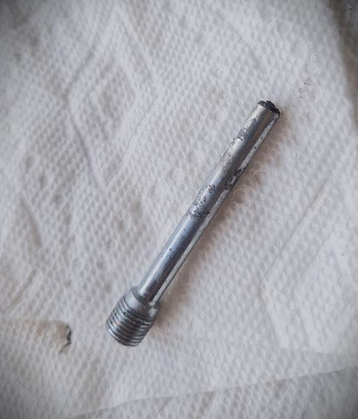

First I removed the dirty brake pad pins,

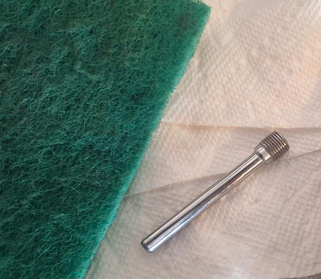

cleaned them with brake cleaner, then scrubby - then lubed them.
I gave the caliber a whack with a board and hammer - to push the pistons in and loosen it's grip on the rotor.
That worked - and also proved that it was not the wheel bearing binding the wheel. The brake was dragging - but the wheel could turn now.

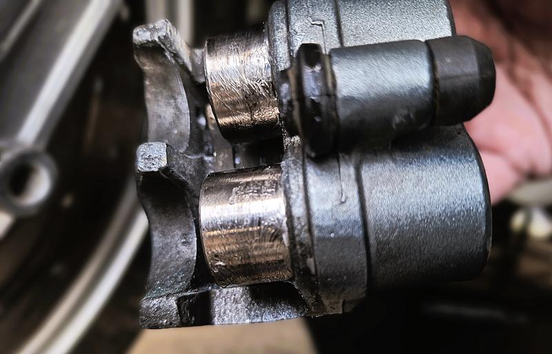

I removed the caliber, then the bracket. And with both shoes in place I pulled the brake handle and the pistons moved out as far as I dared.

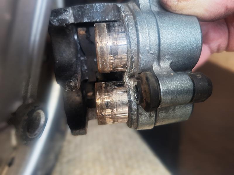

They looked like this.
I used a strip of green scrubby and some brake cleaner to polish the pistons - to very nearly new looking. Applied a coat of Super Lube. (if you want new pistons - you must buy the caliper) The lube here makes them look a mess  - but they were pretty shiny and smooth after using the scrubby.
Pressed the pistons in with the C clamp, assembling everything and getting the caliper slipped over the rotor is always a small adventure. I used high temp grease on the slide bracket. *the posts were actually clean and still well lubed after so many years!)
I attempted to use a new set of pads I had purchased when assembling spares 10 or 12 years ago. Glad the originals were still good - because the holes in the non-kymco pads were too small!

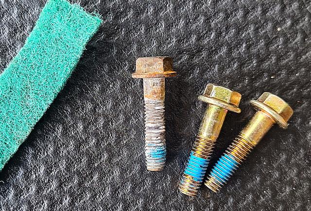

I did replace the mounting bolts with like-new ones from an eBay purchase years ago - a few pounds of hardware from a wrecked LIKE200i.
  So, does the brake work now? I pumped up the lever a couple times, bthe brakes worked - and they released afterwards!
Nevertheless - I will try a nearby ride first before heading out on the road at night.
no animals were hurt in the making of this post..... just don't ask me how many hours it took.

so problem solved? seems to be a cruddy slide pin or sticky piston?  The one thing I'd have liked to see you do before removing the caliper is to crack the bleeder screw loose. If you had a strong squirt of fluid out of that it would indicate the brake line holding pressure and not releasing it.
If you can now squeeze your brake, making sure it holds the wheel and release it and the wheel rolls...a few times...I think you're good to go!
All of our calipers could benefit from a regular cleaning like you just gave yours. Lots of crud can build up in there.

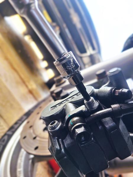

Hawk - note the little box wrench in the pile of tools, for the nipple - yeah, before I started, I placed a rubber band on the lever (NOT a massive one) cracked the bleeder at the caliper. It released some fluid and collapsed the lever. Always leery of opening the bleeder without first putting some pressure in the line. My concern is letting it some air. So, the rubber band.....

Disc brakes that won't release is always stuck pistons.  They look just like yours! I find it's a longer lasting fix to take the pistons out completely for cleaning.  Usually you need an Amazon tool or maybe compressed air to extract the pistons.  The downside is you have to bleed the line afterward, and it takes about 1/2 hr of patient squeezing to finish bleeding.  If you have short arms and can't reach the lever, you'll need some clear plastic tubing to keep the brake fluid from squirting all over the house. Good exercise!
