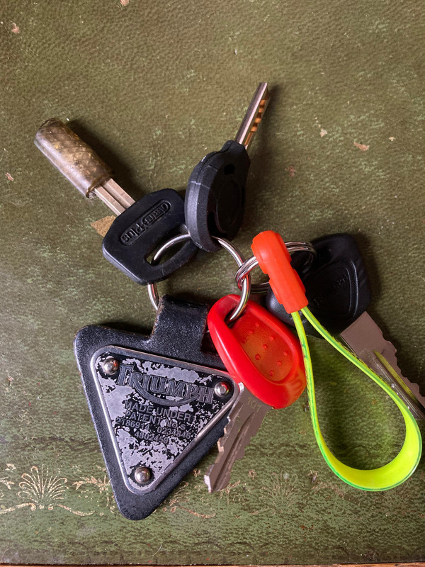

Come on guys please share!  I'll start this off with one from the story I've shared before on here* about my embarrassing attempt to ride off with the disc lock still in situ!  I'll share my cheap and cheerful tip which was a learning point after that red face event.
Take a 2 cm length of fuel pipe and slip it onto your ignition key to remind you to remove the disc lock then after you've done that, park the pipe on the disc lock key.  Simples.  (And yes, I know this won't work with keyless ignition modern bikes!)

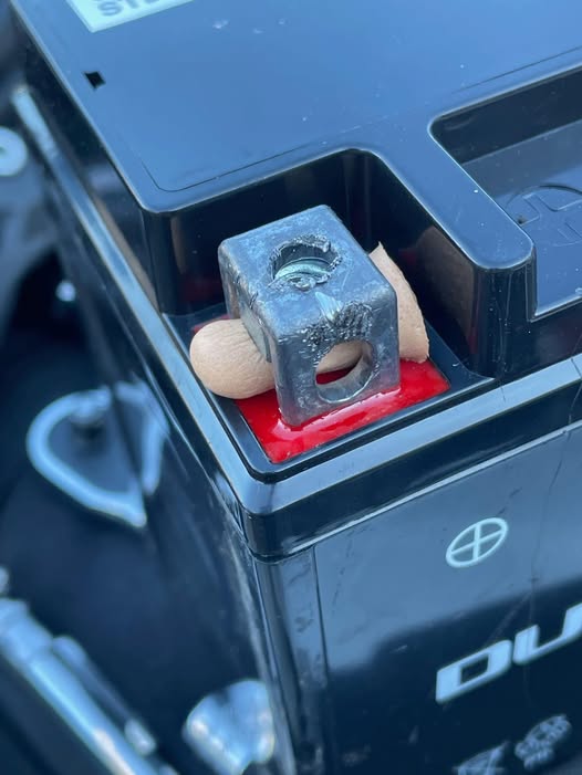

And here's one off a fb Group I belong to:
Just a little tip for you Beautiful souls , certainly helps me when doing maintenance and need to remove the battery . Ear plugs hold the nut in place for you .
You're welcome 😉

saw something similar to your earplug under the battery terminal nut trick...but this person would hot glue the nut up in the top position for a more permanent hold.

I use a zip tie under the battery nut, works ok, but looks like an ear plug might work better

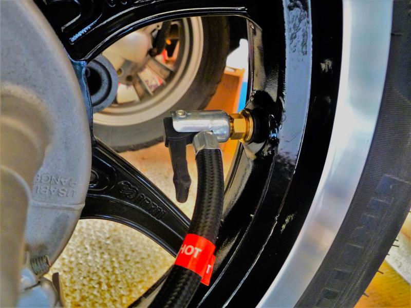

Losing air from the valve stem?
R&R the wheel, or wrestle the tire open in place  and replace the stem....
Or try a COLBY tire valve stem installed from outside the rim.

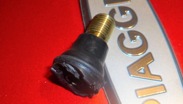

I removed the wheel from my Piaggio and took it along with my new Pirelli Angel rear tire to the dealer for the tire R&R.
A new experience - and as always with a new task - not without some frustration.
Returned home - installed the wheel w/new tire - and began to check the PSI -  found that the dealer tech had nearly ripped the new valve stem off while pulling it through the rim!
I did not want to R&R that rear wheel again and go back and P.O. the service tech with my accusation. Embarrassing for both of us - because I had tipped the kid - $$

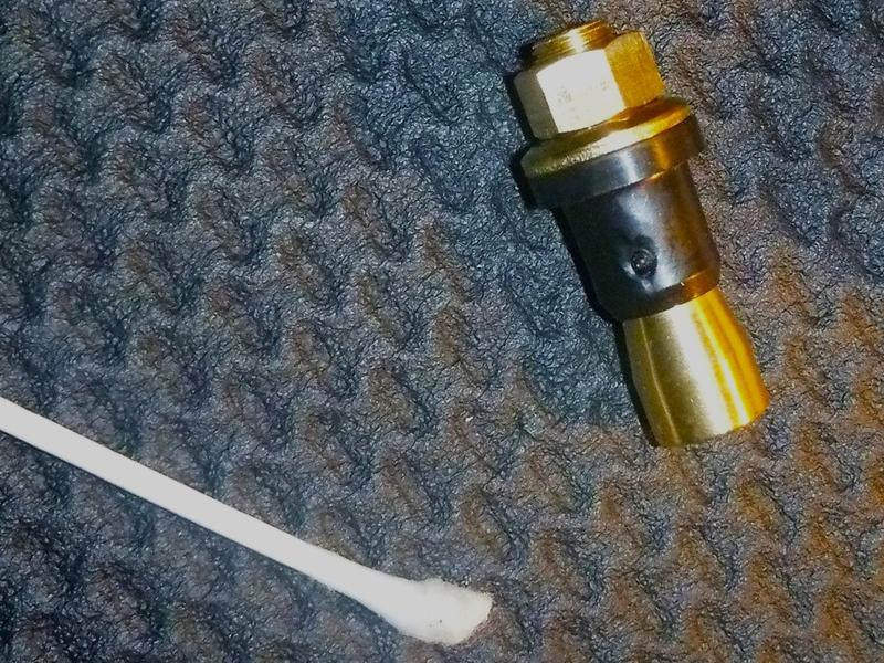

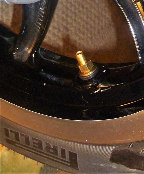

Researched - and found the COLBY system. Amazoned a couple and fitted it.
Clean the hole in the rim thoroughly (Q-tip and alcohol for me)
PRESS the new stem firmly against the rim as you tighten the nut (7/16"
Air it up - check for leaks.
4 yrs on now, and no leaks!
