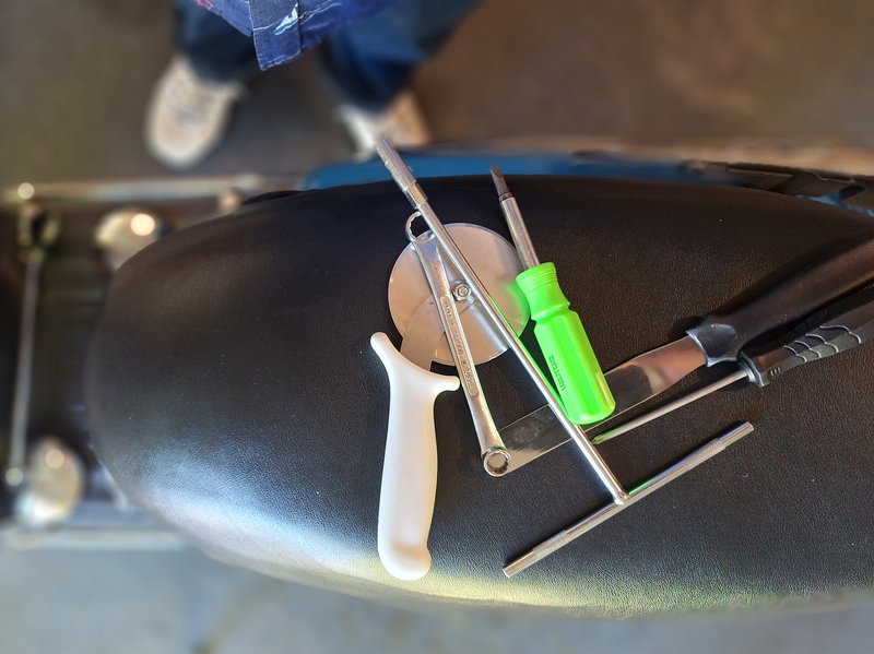

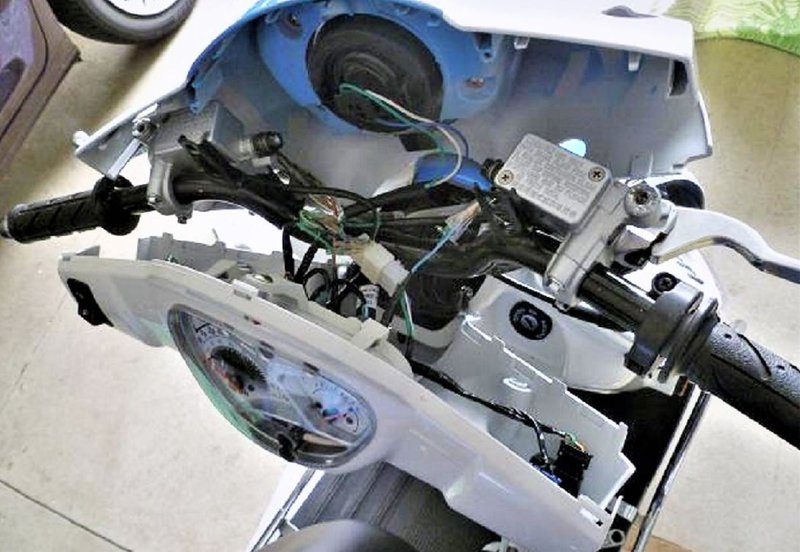

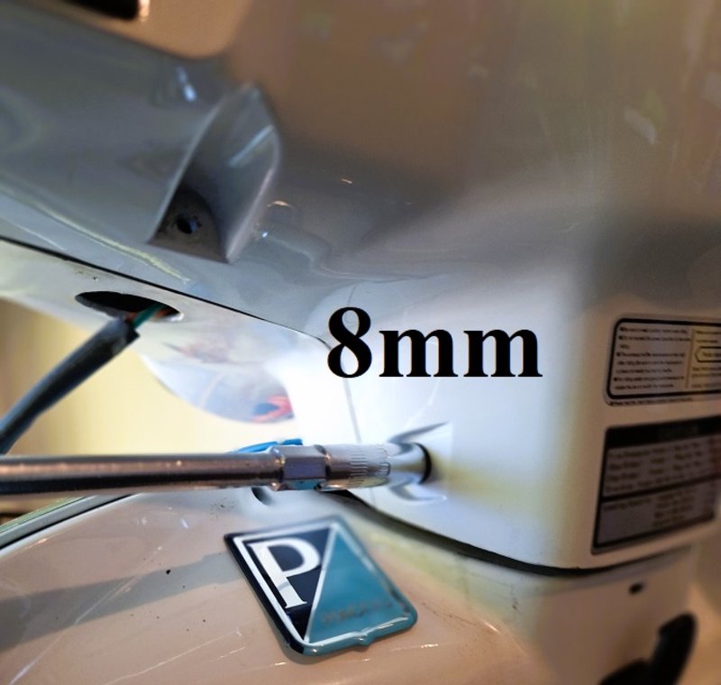

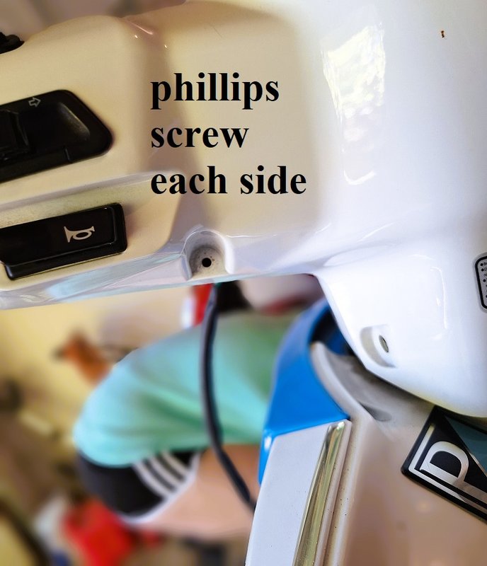

drop the signals and remove panel fasteners in the headstock...pry at the seam of the headstock with a thin blade, pressing down on the rear edge. I use a cake knife and a pizza cutter. Works well for me.
to get access to the fluid reservoirs....and the old fluid. Cover the panels to keep the fluid off of the paint!

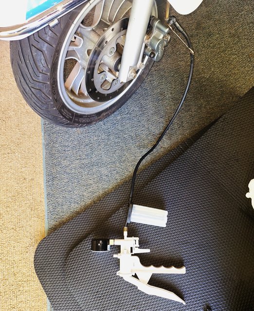

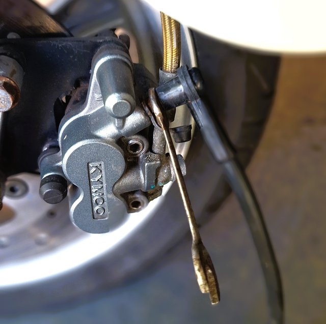

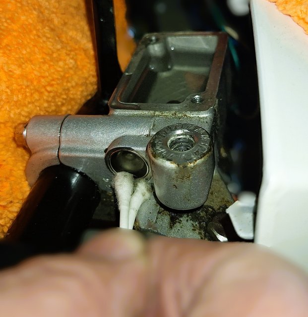

Suck out the old with a Mityvac while cracking the nipple open....

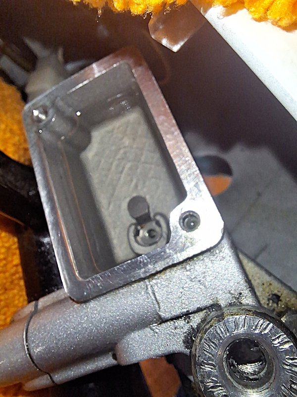

see the mistake here...!?*

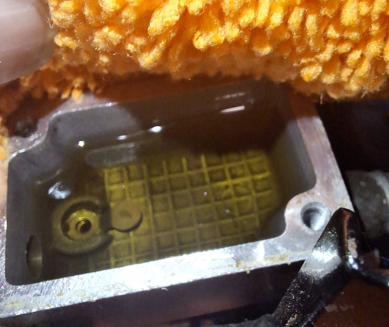

Do not let the reservoir run too low or it will put air in your lines.
I cleaned the sight windows while I was in there....
I put the caps on the reservoir and pulled the brake lever.
Zero resistance. Absolutely nothing!
I had a coffee and wished I still smoked Camels!
I had air in the line.

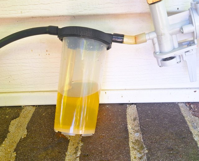

Hooked up the Mityvac and tried again....then I noticed that while I was using two hands to hold the tire and break the nipple open.....the vac was laying on its side, and I saw bubbles, not fluid coming out in its little tank.
I found a way to set the vac upright and worked the project again. In 5 mins I had a mighty hard pedal!
I went to the rear and found the nipple frozen. I've broken enough crap to know when to s t o p.
Put a little magic spray on it and will try again, some day....

Basically, you pump handle to create a "suck" on the brake nipple. Then open the nipple with a wrench for a second or two. Draws down the fluid.
But, probably best to put some clean fluid in the vac's 'tank', covering the end of the straw in there - so only fluid, no air, is drawn back into the line.
Now if I can just remember this, the next time!
