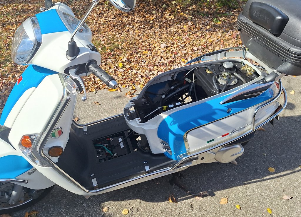

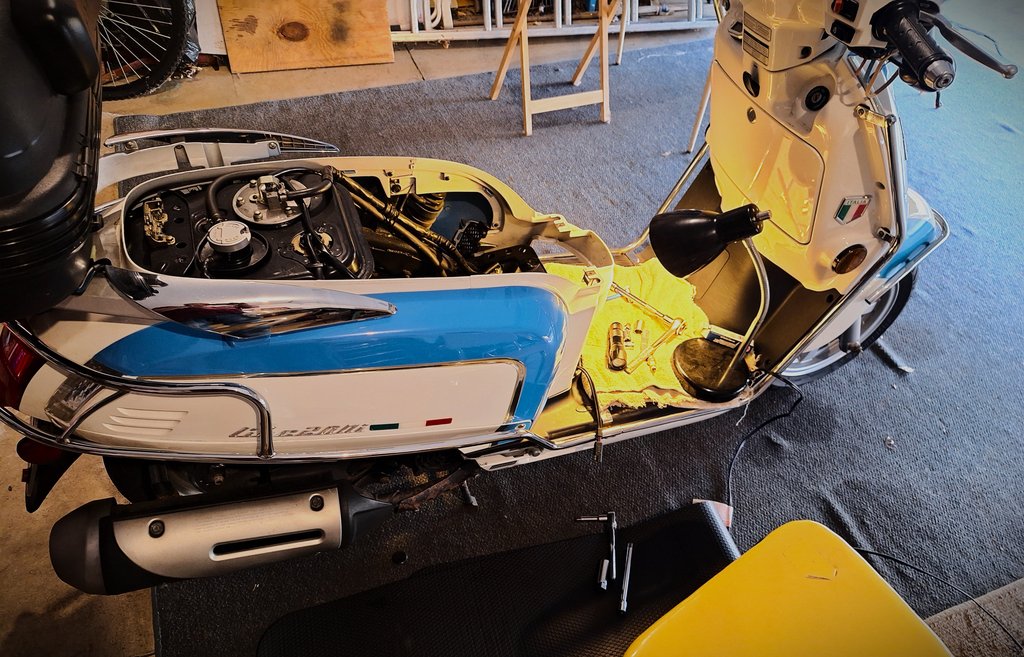

Removing the seat is just  4 bolts and 2 screws; 3 screws removes the battery cover; 2 more removes the front panel giving very easy access to the valve cover and spark plug.

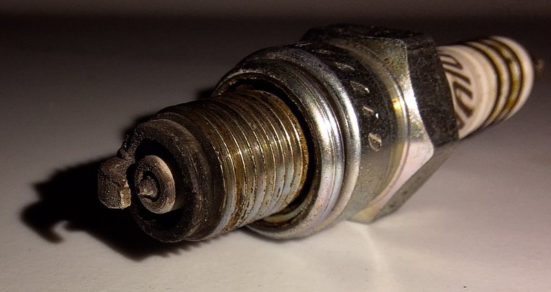

Remove the old NGK Iridium.....paying close attention to the angle of removal - to reduce chances of cross-threading the new plug!

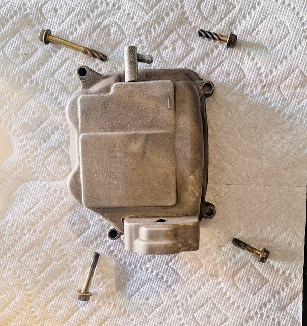

4 easy 10mm bolts drops the valve cover. mind the location of the bolts.

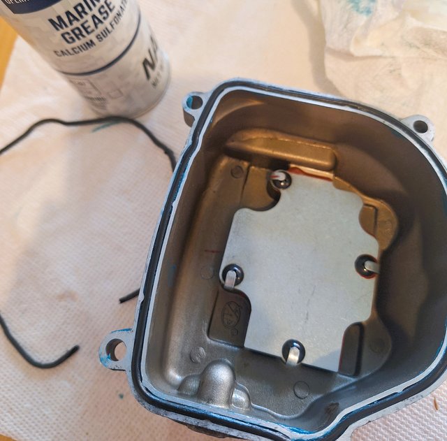

Renew the valve cover gasket - insuring it's snug in the pinch points which Kymco gives us! You drop the gasket during reinstall - you'll have an oil leak and will be starting all over! I use a little grease to hold it in place.
