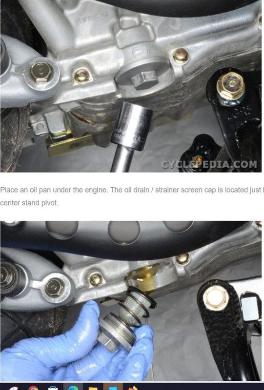

I have a 2011 like 200i and ive been changing the oil for 2k miles every 500 but me and the auto store employee were both wondering if it has an oil filter/if it does where would it be?

No, no oil filter.
It does have an oil screen and it can be cleaned every couple of oil changes.
Thing which looks like a thimble/screen. Rinse in gas, dry paper towel...pay attention to how it came out - replace the same manner.
Do NOT overtighten this - snug is very good.

This plug is pretty soft metal. If you strip the hex-head trying to get it off...use grips to grab it and buy replacement kit on ebay.

awesome thank you so much 🙏 if the screens dirty would that cause any issues and can it be done after an oil change or should you only before?

When you pull that screen it will drain your new oil!
So, clean it next oil change will be fine.
Most of us checked the screen and removed the oil drain plug at every oil change.
But, finding nothing new in the screen - we began removing the screen only every few oil changes.
