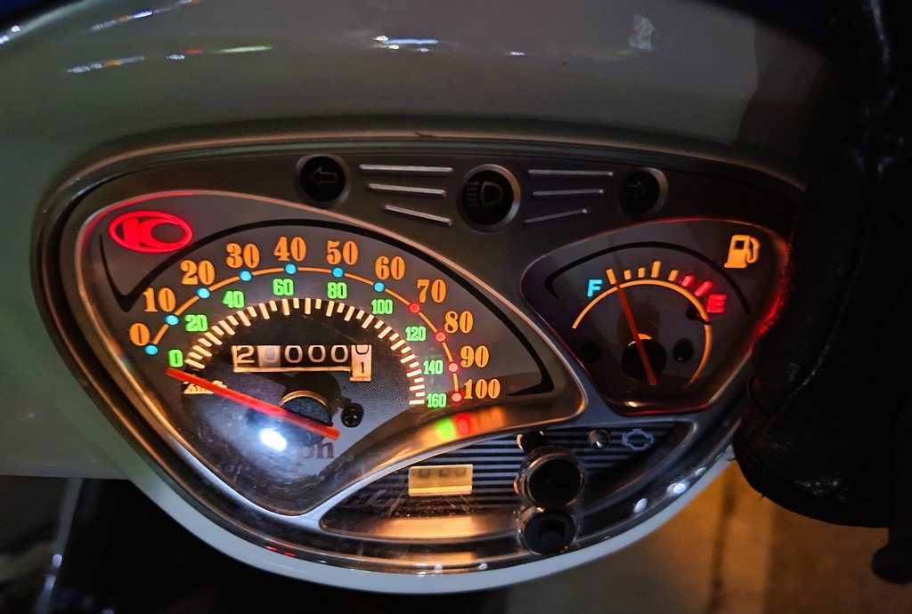

reached 20,000miles on my Kymco at 5:30 Friday morning....was in the middle of the street by the police station so I pulled onto the sidewalk (in front of 4 off-duty deputies!) to record the event.

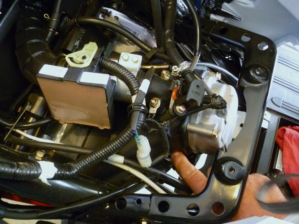

About 10 mos into ownership the LIKE developed a severe stumble when cruising at a steady 30mph. Guess where I like to ride?!
In and out of the dealer and they could not replicate it. "Idles great, easy starts, WOT is perfect.???" Could not get them to listen, "YES, but go 30mph and wait....!"
I told them to keep it until it ran correctly.
Now that I saw how much I loved scooter riding - I bought the lovely red Forza!
 The LIKE sat at the dealer's for a few months.
Finally I got help from the KymcoUSA customer rep (guy named Rocky) and from Crossbolts (he lent me his Kymco diagnostic tool) - and my little public complaint blurb on youtube.....all of which got things rolling!
Karl and I proved the TPS was ill - Rocky saw my youtube and told my dealer to:
A) buy the Kymco diagnostic tool
B) replace my throttle body
Under the 2 yr drive-train warranty I got a new throttle body  - and it has been perfect since those days. There have been a very few similar complaints from 2012 LIKE200i owners here. Apparently a small batch of bad TPS/throttle body went into our scooters around 2011/2012.
