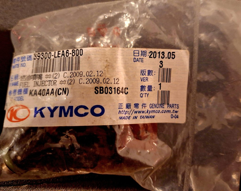

The fuel injector we put in was “ EPSIRMP IWP182 Fuel Injectors Compatible with
Piaggio Gilera Vespa PI8732885 GTS250 300 IWP-
182” is this one alright for a like 200i or should i look for a different?

Took pix tonight of my spare injector in OEM parts baggie.
@$70 from various KYMCO parts sellers.
Like:
