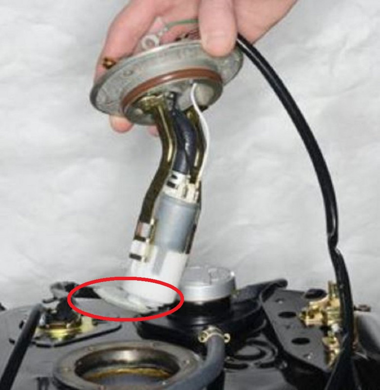

Just a thought. Had a few cases of this.
(Never heard of a problem with fuel delivery due to a clogged filter (on the end of the pump)
https://www.youtube.com/watch?v=KSrDE0xpbPw
I suppose it could be a problem with the ECU -  normally a very robust/reliable part of the EFI.
I'm no expert - but it seems to me to be a problem with fuel delivery - it stops delivering any, or not enough fuel. Clogged for some reason.
Valves off is a "hard to start" symptom. But would be strange at only 4800 miles.
