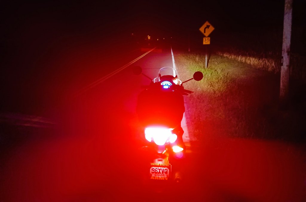

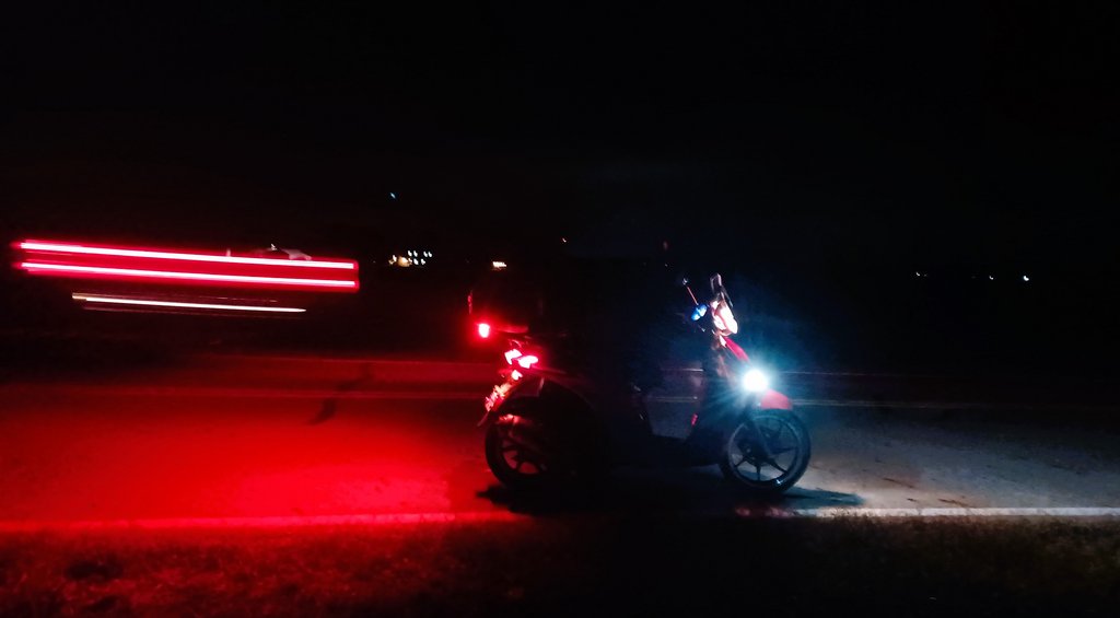

I don't recall ever using the hazards on my scooters...since I don't travel interstates. During my freq photo stops on rural roads I set my turn signal and rubberband my very very bright brake light systems...watch for traffic- (very easy to spot 'em in the dark🙃)
I wager that I probably ride in the dark more than most - my every ride starts in the dark. As such I'm well practiced in safe lighting situations....and get along well without that nice yellow switch.
