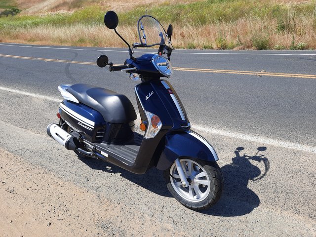

Got this Like 2 days ago , yesterday took it near the bay .
and it died about 2 miles later.   Was bad fuel hose .  The one thats located in the tank and is known to
rot out.  See Stigs sticky in 200 forum
Fixed it today and mounted windshield and went out in the valley.

Re: Like at the bay and out in the valley
« Reply #1 on: June 26, 2023, 11:07:00 AM »
Nice photos, thanks for sharing.

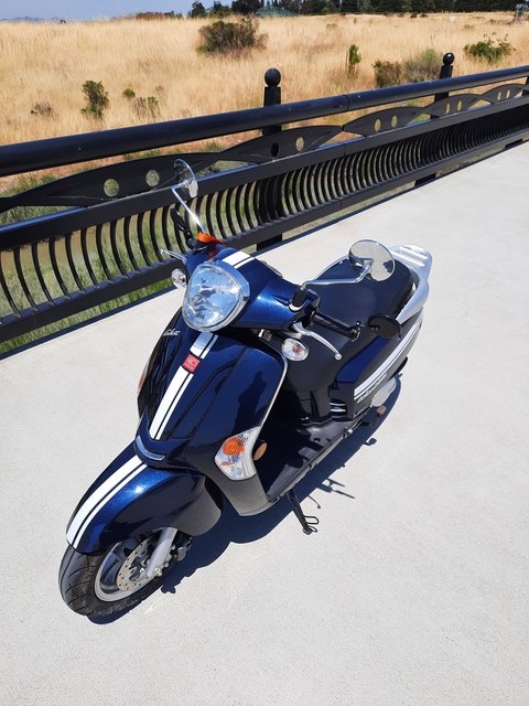

« Reply #2 on: June 26, 2023, 06:58:53 PM »
Nice pics!
