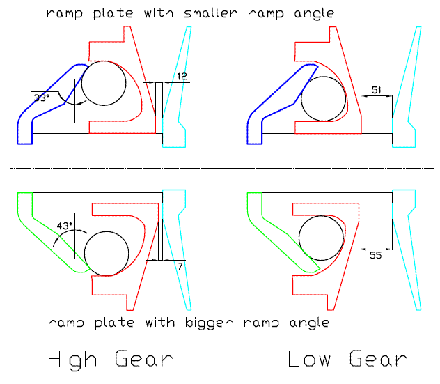

Has anyone tried to remove the spacer (washer) from behind the variator to allow it to push the belt further out and achieve higher higher speeds?

I wouldn't attempt that. It's there for a reason! Critical to the alignment of the variator and back clutch. I presume something would get chewed up really fast ie the belt and crankshaft bearings would come under tremendous stress. Try different shaped sliders like the Dr Pulley or Tech Pulley Flying Roller to achieve the same you have mentioned.

NOT ON A GTi300 or DT300i (same engine/CVT) !! Not if the washer you are referencing is the one on the crankshaft of the engine!! Real bad idea. First, it would widen the initial spacing of the front sheaves(pulley faces) raising the ratio, inceasing engine RPM for given road speed and REDUCING top speed.

agilebda: Different sliders would not help, because the once the ramp plate reaches the washer, it can't continue moving towards the crank shaft. Different roller shape can only change the acceleration profile, but has no effect on the pully ratio, therefore no effect on the top speed either.
CROSSBOLT: It is a GT 200i. The washer removal is commonly done on smaller scooter engines, to gain more speed. If you look at the variator cross section below, the spacer/washer sits next to the ramp plate (the crank shaft bearing and seal are on the other side) and by removing it, the ramp plate can move further out towards the crank shaft and the rollers can fly further out, therefor the V-belt can move further out on the pulley (because the two pulley halves are closer to each other).

I did some research on this. You guys are right. Removing that washer would actually reduce the speed.
