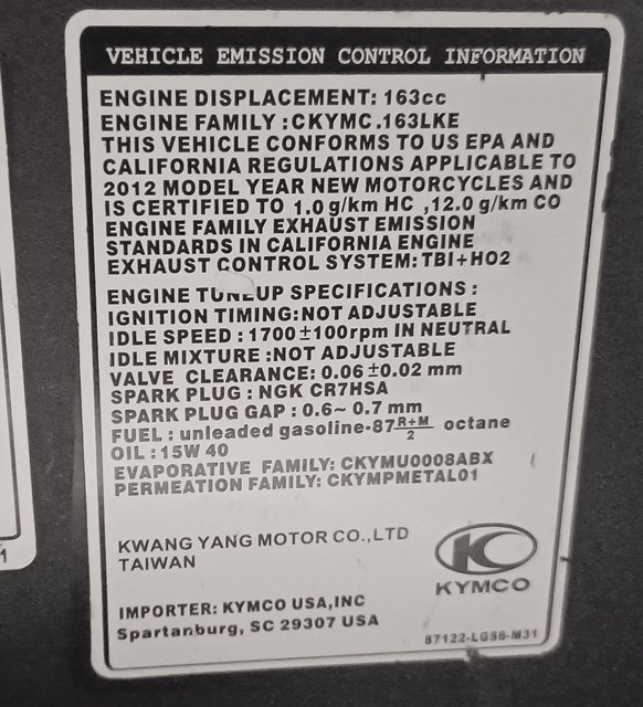

Always a bit of confusion when it comes to checking my scooter's valve lash.
Both the under-seat sticker on my LIKE200i and the Cyclepedia Service manual agree on these specs:
 .06mm +/- .02mm (i.e. - .04mm > .08mm)
While youtubes are setting the valves at .10mm.

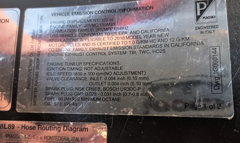

The under-seat sticker on my Piaggio Liberty150i specifies .10mm for the valves, while the Piaggio service manual and the owner's manual specify .08 for the valves.
So, I placed a phone call to PiaggioUSA Hq in NYC - in 2 days the service tech there replied that the under-seat sticker contained the most up-to-date info. "Use that measurement."
So I do.
I note that neither manufacturer specifies a different setting for the exhaust valves.
what do I do with the LIKE?
depends on how I'm feeling that day!
No, actually I like .08mm > .10mm. for the past 10 yrs and 19+K miles.

I noted similar results for the AK. Things like what fuel and some other specs are different in YouTube videos and service manuals but then I realized that those specs are for earlier models in Europe and not for the USA versions. Seems it does make a difference after converting for units of measure and even just updated information for minor changes in the engine for the USA. I go by the sticker in the storage box as most up to date than even the owner manual when there is a difference. Even my owner manual, which is supposed to be written for the USA version, calls for 91 octane fuel. But that's MON and not PON... which is 87 octane in the USA (and per the sticker). So the sticker is the most updated information.

Sore point from 2009 that Kymco ops and service manuals and stickers don't agree. Cyclepedia was hired on to take care of rhe books' part and that appears to be a bust. Being (begrudeingly) fair, I have no idea what Asian Mystery Management the cyclepedia guy had to cope but it appears all of you/us have done a WAY BETTER job of getting information straight AND supplying it when the question was posted.
It is outrageously inconsistent tho have decades and many 4t models using .004"/.1 mm valve lash and then one or two models have .06+/-.02 mm or essenntially half of what has been Kymco/Honda practice.
Same with fuel requirements. Bikes that go to Asia and Europe are 91 MON. Bikes to the USA are 87 (RON+ MON)/2. That's Research Octane Number and Motor Octane Number. Books and stickers for two parts of the world. A simple management function to rectify.
While we are at it, how about light requirements? Asian and European riders are smart enough to have their lights off for starting but not Americans? Lights are on when key is on and THEY STAY ON while the starting sequence is activated! That is just dumb design. Change a couple of wires and it's relay action that kills the whole lighting system while starting. OR a light wiring scheme like the side stand switch where the OWNER DECIDES if he wants idiot protection on the side stand or not. But how about an up to date wiring diagram that matches the model and geographic scheme?
Just another management activity that seems beyond Kymco USA....see what happens when you bring up valve clearances, Stig?
