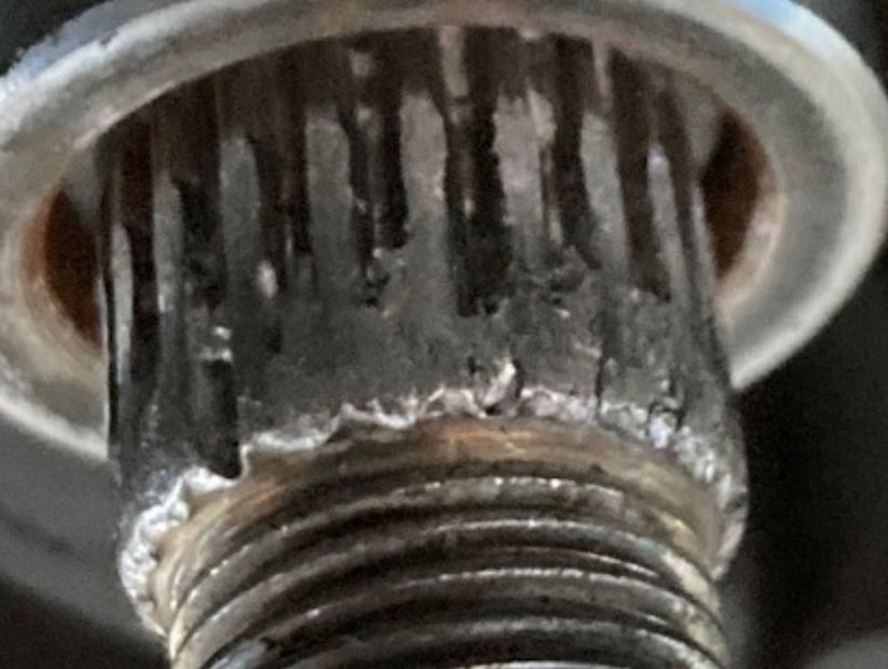

as someone who removed, disassembled, reassembled and reinstalled an engine in a Kymco scooter last year...it's really not that difficult. A quick parts lookup shows a crank at $294 USD, plus another $50 in gaskets and crank seals...but many hours in the workshop.
so my advice is to...look for the new scooter! Perfect excuse to the wife...but honey, my crankshaft is shot! I have to get a new scooter!
Re: Diagnostics Advice sought (X-Town 300i)
« Reply #62 on: February 14, 2023, 09:17:48 PM »
Yeah, my first thought was "new crankshaft"!.....(I priced that crank....then there is the labor!) but that was so horrible - hoping a fix was possible.
IF indeed the tops of those splines are scuffed and missing some steel .....as they seem to be back there towards the boss.
Then yeah, you risk having a complete CVT failure some day when you are in some road situation that would be very unsafe.
Belt breaks are scary enough - but if things bound up in there with a shattered front pully ...a locked rear wheel would be bad.

Neil, before you decide to dump your scoot and sell it for parts, get another opinion from somebody who is doing machine work.
For a workshop it's the easiest solution to tell the customer, financial writeoff, costs more than its value.....yada yada yada...
Most of them are afraid to do such a motorjob, for they lack experience.
What I would do if I had this scoot here in my workshop:
-take this drive boss off as suggested
-put this boss on the lathe, cut off 2mm
-now I have 2mm more of grooves for the new CVT
-install new CVT and see how it works
IMHO there is still enough material to hold your fan blade.
But as I said, this I would do on my own scoot and to my own risk.

The bad news is that the workshop says the crankshaft is junked.  eMail from the mechanic says "Sorry crank destroyed , new crank required.
Cranks cost approx. £450 engine needs to be split in half , labour wise about £400 and several other parts do wish me to price up?"
Not what I wanted to hear!
My response so far is, before asking him to go ahead and repair, what is its part ex value, as is, against a DTX320 (which I've had my eye on for a while) to see if that might reduce the hassle as they're available within 24 hours.
To be continued...
Not by what I see in the picture of the spines! Someone already mentioned too scrape the aluminium out of the splines. (You like my "aluminium? That's what you guys say in the movies!") The spines are hardened after being formed so no real problem, in my opinion. Loctite "Bearing Mount" for the splines and Loctite Blue thread locker for the nut (or equivalent).
That crank ought to be fine if that shaft is not bent. This is the point to tell me what I have missed the makes this dissertation invalid!

Thanks guys, for all the suggestions and moral support. My thinking today is that I’ve now seen two catastrophic CVT failures on this scoot* and I’m losing faith in the bike. The marque I still have a good opinion of, but this machine?…
So I’m inclining towards cutting my losses and moving on, taking it all as a sign from a higher power!  I’ll keep y’all updated.
Yes, I see what you did there Karl.  I’m sure if you have the time, skills and cash it’s eminently fixable, but I’m deficient in 2 out of 3 of those categories!  My objective now is to get my preferred form of transport back asap. That’s pointing me in the replacement route.
