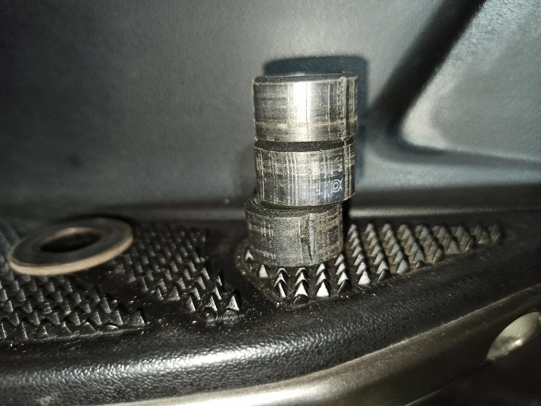

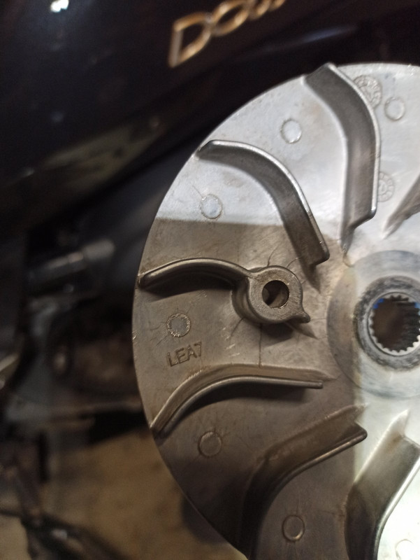

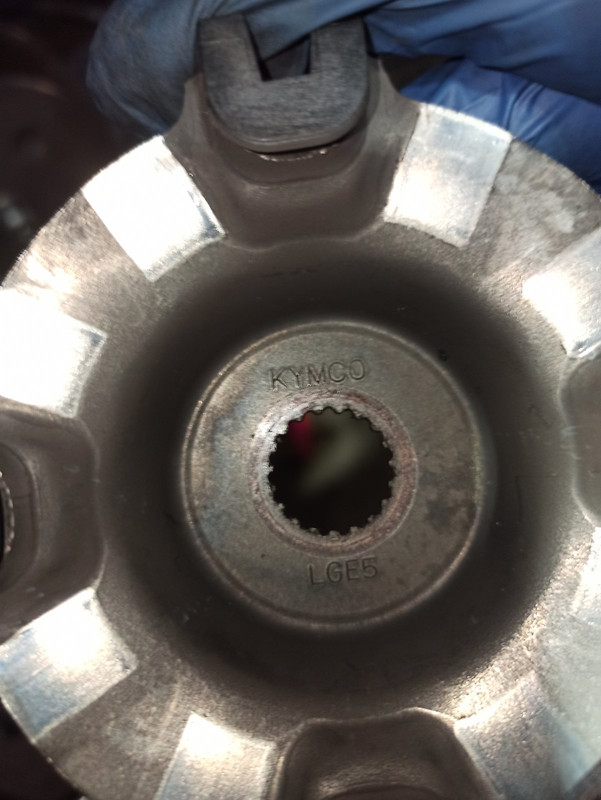

I'm the newest owner of 2011 Kymco Downtown 300i.  On test drive I spotted that WOT RPM's are 5000 and they should be at least 6000+. I talked to previous owner and he told me that he replaced variatior with brand new oem unit, changed rollers, main clutch spring and 3 clutch pad spings. Why he did that, he couldn't explain. He included all old parts with the purchase. One variator is LGE5 and it was made in 2011 ( I think that this is an original that came from factory) and LEA7 made in 2017 - dates are printed.
Regarding the clutch I have seen white colored central pring I'm goint to replace it for original one.

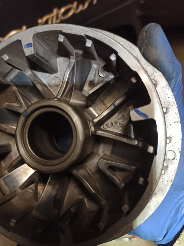

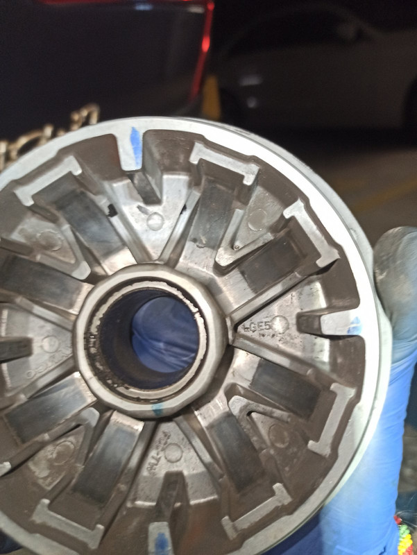

Today I removed xmission cover these are parts that I took out :
Plate Ramp - LGE5
Face Comp Movable Drive - LEA7
Face Drive - LEA7

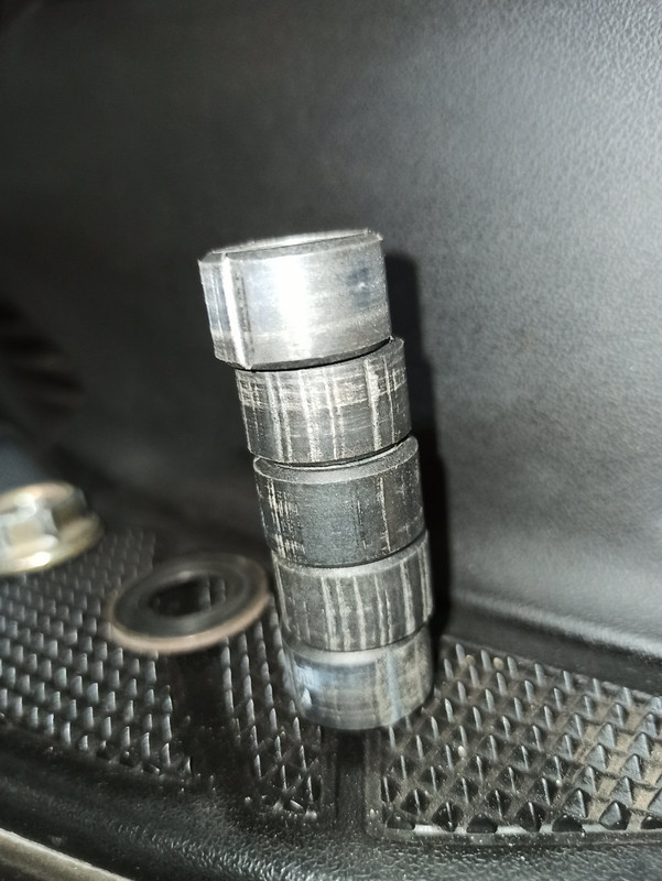

Rollers have very unsual wear - not flat spots like you would expect but lines of various depth. I got 3 set of rollers - all of them have this strange wear pattern and all of them are from brands like Malossi or Bando.  I thnink something is wrong. My guess is that Face Comp Movable Drive should be LGE5.
thanks for help - here are some pictures:

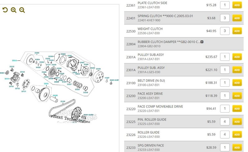

www.oemmotorparts.com/en/genuine-oem/kymco/scooter/downtown-300-i-abs/2011/drive-pulley   I searched for oem parts and for 2011 found this. As you mentioned it looks like it should be LGE5 on the face comp moveable drive. The roller wear lines could be from the ramp end edge.

yep, I was going to link to a parts schematic just like NorWeWa..

I would see three reasons for this strange roller pattern.
A) somebody messed with your CVT and changed the boss or some other part
B) rollers are simply to small in diameter and were demaged by ramps edges.
C)  gliders are heavily worn out
In all cases a severe research into OEM measures should be done.

Update regarding geting back to stock config - I put toghether variator from following parts :
Plate Ramp - LGE5
Face Comp Movable Drive - LGE5
Face Drive - LEA7
8 piecies of 15 gram 20x12 Aliexpress sliders ( I will make another topic regarding Aliexpress sliders after few more miles to test things out )
On the clutch side I had put OEM original contra-spring while getting rid of Malossi white one which was shorter and "weaker" than stock one. I made a test ride ride and viola - @ wide open throttle RPMS are back to 6500 instead of 5000. Gotta test scoot a little bit more for full report but so far so good - thanks everybody for help !  :)
