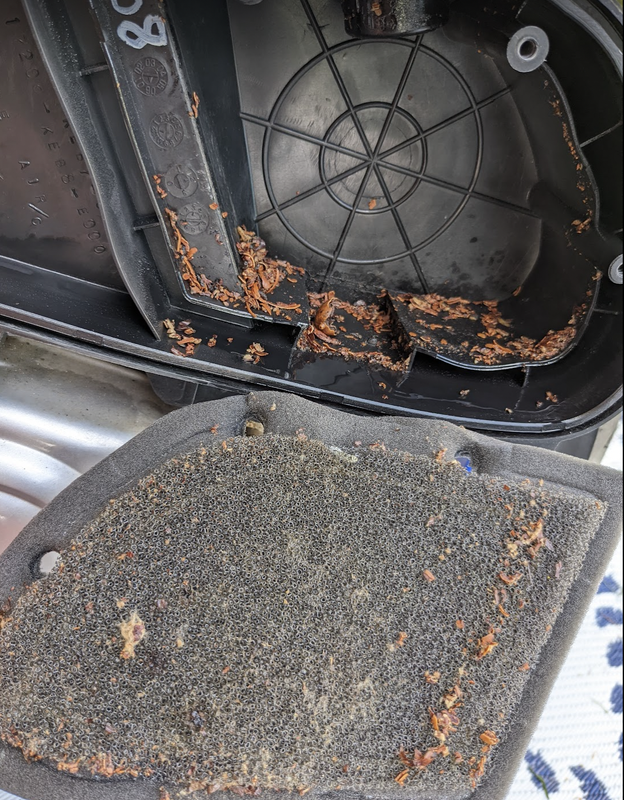

I did clean the carb again this morning and the stumble is gone YAY! While I was at it I opened the CVT so make sure mice didn't do what they did to the airbox (some nuts and poop) and CVT looks clean, no corrosion, everything moves free. While I had it open borrowed an impact from the neighbor and removed the restrictor (ground off the shoulder from the pin) now it goes 30! Rollers are mint, no signs of use or wear, less than 10 miles on them.

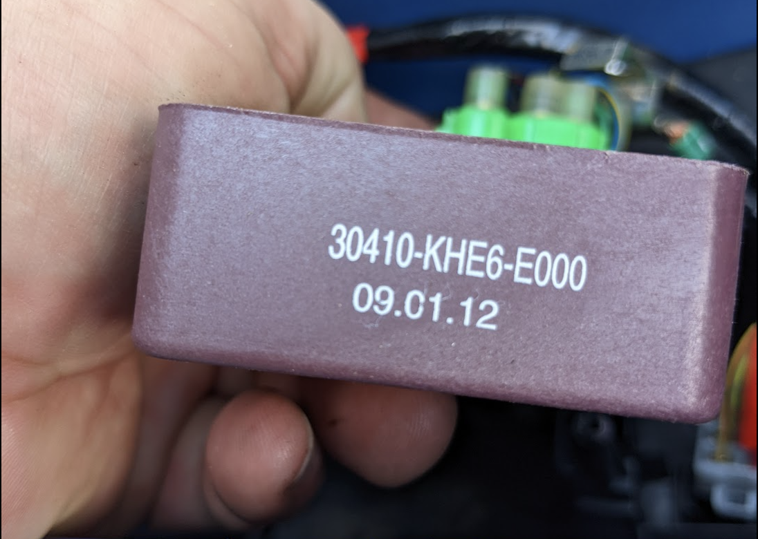

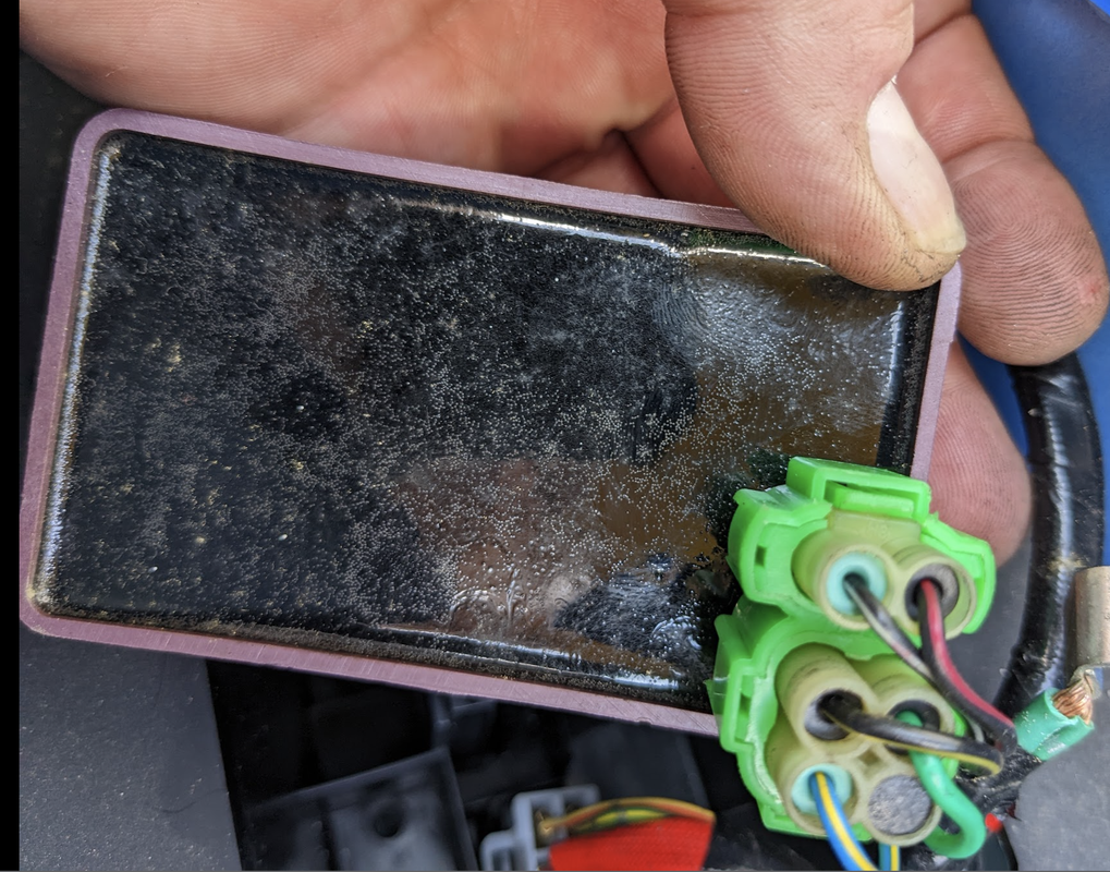

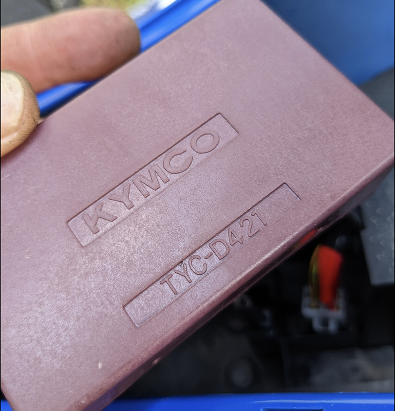

Found CDI under the battery box, pics below, I'm guessing its the one that needs to be cut/ground? Still thinking about the pipe and jetting?

So, I found a stash of CDI's at the old shop, one of them has same TYC-D421 stamped on top and a green wire loop that can be unplugged, note says "speed control CDI", gonna try that one, hope I can break 30mph
