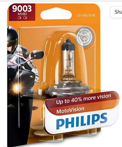

Glad you like your new bulb.
Actually - that adjustment screw under the headlight cowl does move the beam up and down.
I don't know what is moving when you turn the screw - but it does move the beam.
Me - I'm still riding with the Philips MotoVison 'orange' bulb I put it there several years ago.
I like to think that with the orange tint the bears have an easier time seeing me coming.
Truth be told - I haven't hit one yet , I don't think.
