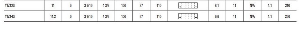

Battery: YUASA > YTZ14S (or YTZ12S....1/2lb lighter than the 14 Ah) both will fit & replace the orig. 8Ah or9Ah battery by trimming 5mm off of the posts on underside of battery cover. (use a hacksaw or a steak knife to trim)
Is a 14Ah battery overkill? Nah, not when you want good starts 35 miles from home on a 15°F day. The EFI loves a healthy battery!
