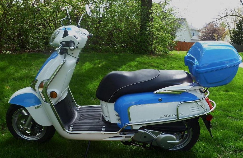

Dear LIKE 200i owners,
on my LX, MY 2013, I do have a piece of metal
 (pls see pic) which I do NOT have on my "regular" Like, MY 2010.
It keeps the mainstand stop-rubber from touching its CVT underbelly.
My Q.: Is this part only on LXes or has my predesessor simply lost it from my regular Like, MY 2010.

Re: LIKE 200i underbelly brace?
« Reply #1 on: May 05, 2021, 11:03:26 PM »
Yeah, you're scooter lost it. Probably left off after a servicing. My neighbor owns 2 Like200i's, a red one and a black one. This part is on both. Their scoots are maybe 4 yrs old.
Well, there you have your latest project!😊

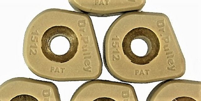

But another issue. I was curious how KOSO square CVT gliders would perform. They are very similar to TECH PÜLLEY, nicely finished and precise on a hundreth of a gram. But has to wait until tyres arrive, too. Will report.
(pls see pic)
Those KOSO's look like Dr Pulley knock-offs.
Are they less expensive?

Yes, those KOSO square rollers (!?) look very "copy" and are here in Italy about $10,-. Let's see how they do and last. Like I said, want to try.
My original parts are stashed away too, but like to experiment with different setups.
