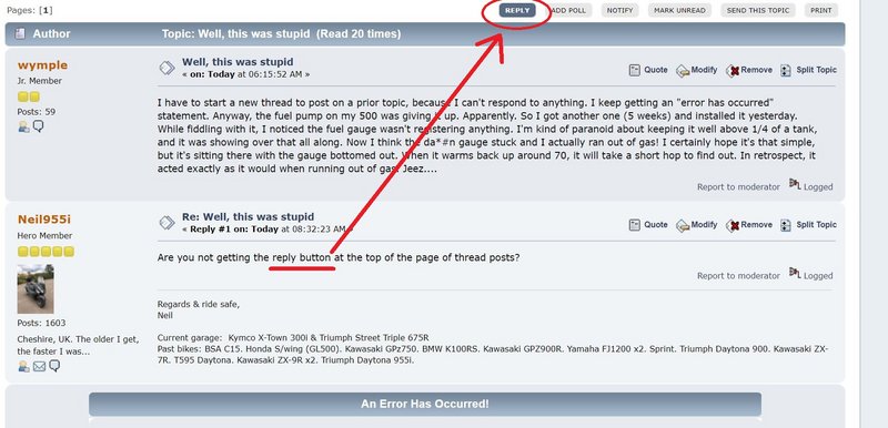

I have to start a new thread to post on a prior topic, because I can't respond to anything. I keep getting an "error has occurred" statement. Anyway, the fuel pump on my 500 was giving it up. Apparently. So I got another one (5 weeks) and installed it yesterday.  While fiddling with it, I noticed the fuel gauge wasn't registering anything. I'm kind of paranoid about keeping it well above 1/4 of a tank, and it was showing over that all along. Now I think the da*#n gauge stuck and I actually ran out of gas! I certainly hope it's that simple, but it's sitting there with the gauge bottomed out. When it warms back up around 70, it will take a short hop to find out. In retrospect, it acted exactly as it would when running out of gas. Jeez....

Are you not getting the reply button at the top of the page of thread posts?
Re: Well, this was stupid
« Reply #2 on: April 21, 2021, 12:37:34 PM »
Click on that and make your reply.
