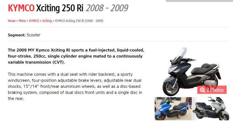

Helkp us out: what is a "250ri"??

« Reply #3 on: March 14, 2021, 03:38:15 PM »
