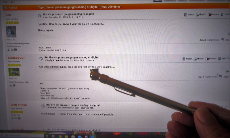

Other information: Most dial gauges use a bourdon tube to operate.
Pen type air gauges that can be pulled or screwed apart can be calibrated. Screw the gauge apart, remove the Huva valve and adjust the screw down inside the tube. Test it against a Master gauge or a gauge you have confidence in as being accurate.
I am in the process of testing all my gauges. So far my "air gauge testing station seems to be working good.
I hook my "air gauge calibrator" to my 110 psi air compressor and set the pressure wherever I want. 30psi, 40psi, 50psl, 65psi. and check questionable gauges against my Master gauge.
