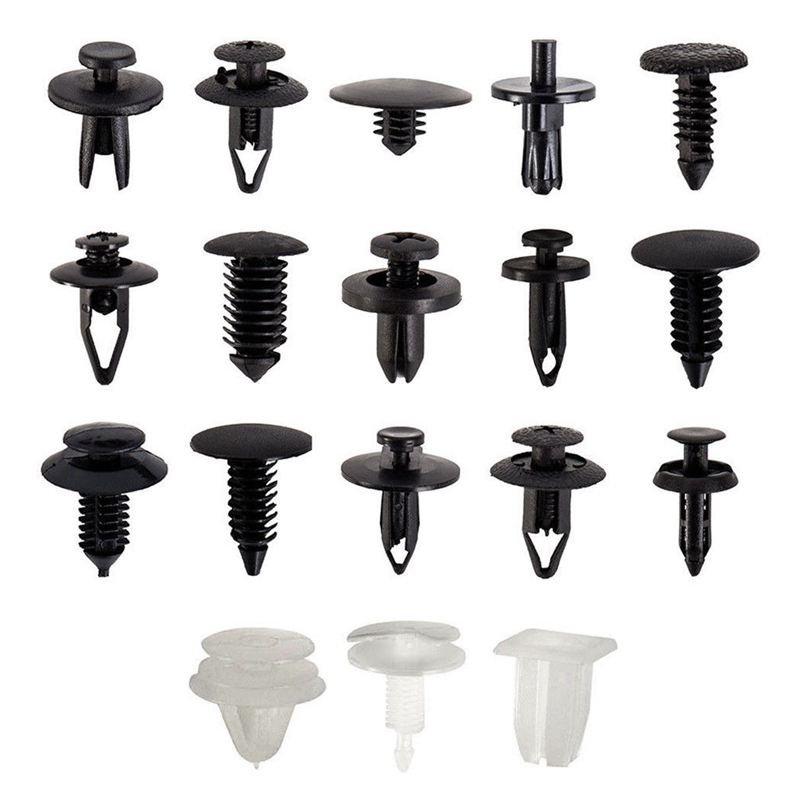

@Lars
This plastic might be s clip which is appr. 15 mm in diameter and has an about 5 mm middle bolt. Try to push this bolt about 4 mm into this clip. Then pry this whole clip out and the fairing should come off. At  least st LIKEs works in this way.

Panel nuts/rivets/fasteners come in various forms and are common panel fasteners for motorcycles and scooters.
Of course you pry up, or push in (or unscrew) - the center to unlock the fastener. Locking is the reverse.
