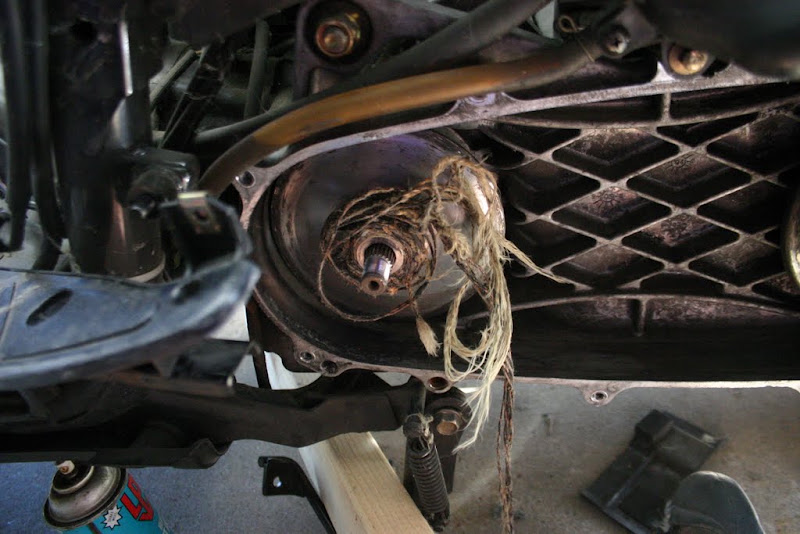

Turns out the drive belt shredded and was wrapped around the drive pulley. Surprised that it only lasted 2200 miles. Will order a new one and be back in business. Thanks for the tips and advise.

New guy here. I am curious-would a belt shredding cause any damage to the variator? would a person remove the belt and start the engine to rule out variator damage, i.e. runout issues , imbalances etc.? Seems like a blowout at 70 with accelerating might cause a bit of unequal tension on the variator. When you put a new belt on is it prudent to start the engine and observe for smoothness before putting the trans cover back on? just curious.
The belt shredding COULD cause damage if it wrapped around the Rear sheave and cased the bike to skid to a stop but you would know this immediately.  If the belt failed (like mine has) and you lose power and coast to a stop but the engine still revs smoothly, you know the belt has failed. When mine failed (and most others also) the failed belt becomes fluff, string, and rubber shards.  The interior of the CVT is covered  in rubber "skid marks"
I cleaned it all out, replaced the roller/sliders (worn) and the failed belt.  You can run the CVT without the cover to see that all is good.  The belt does a correct direction.  Follow the arrow printed on the belt.  The cover is not air or water tight.  It is there to protect the belt and other items from being hit by road debris and to protect the rider.
