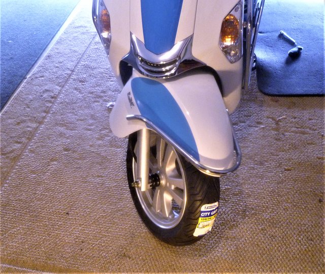

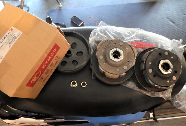

2012 LIKE200iLX, 17,500 miles:
new OEM Kymco Clutch
new OEM Kymco belt*
new 14gm Dr Pulley slider weights*
new Michelin City Grip on the front
2020 was an unusual year for the LIKE, new parts wise. The scooter has not needed any new parts for a few years - just oil changes and valve checks.
* only replaced belt & Dr P's because I was in the CVT for clutch replacement.
