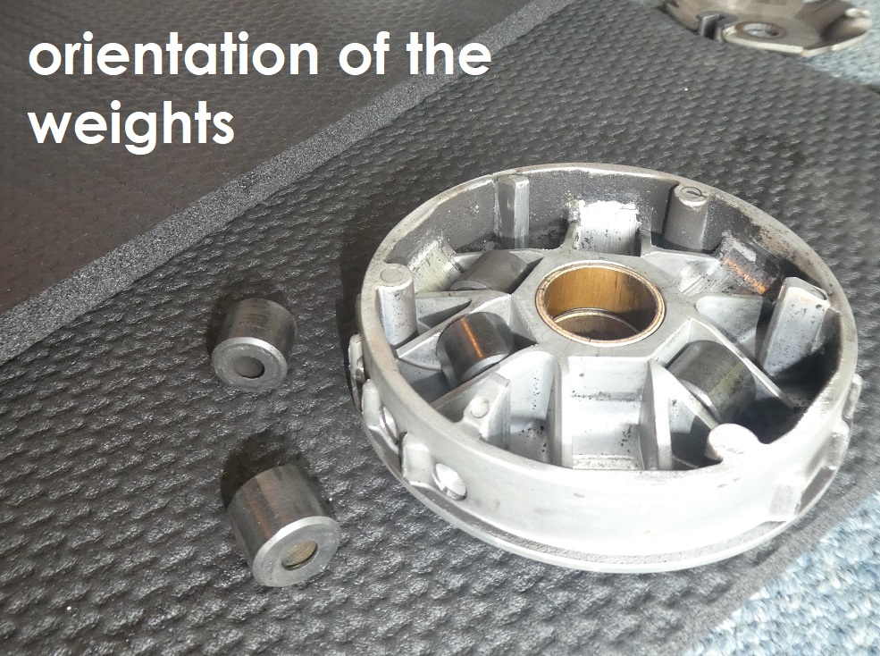

I've still not been able to identify the root cause for it to fail.  Pulleys all feel smooth, and with a new belt installed, the variator and clutch assembly all appear to work fine again.   But I wasn't 100% sure I got the roller installation correct.  Are they supposed to be installed with the side having more plastic on the side as shown in red?
The service manual says they are supposed to be installed with the more plastic side toward clockwise, but after thinking how the engine rotates not sure if they meant that is supposed to be "toward clockwise" while disassembled, or when looking at it post-assembly.

was watching a video from Robot with Vespa Motorsport the other day and he was working on the variator from his BV 350. He mentioned that the rollers were supposed to be installed with something oriented to the clockwise position...and he specifically said that clockwise meant as you were looking at the open variator, and not as installed on the scoot.
Now this doesn't definitively mean this applies to your scoot but I'm realizing that all these variators seem to work the same way, no matter the manufacturer.

The side with the most plastic goes like this....
These were lifted straight out of a factory install....and set down & not flipped over.
What plastic?!
These rollers look like aluminium ?
If so - do they last longer / shorter than “ceramic “ (or whatever it is) type rollers ?

Plastic, polymer, nylon, ...whatever, .but never heard of metal.
Lots of these are dark.
One end is often more open than the other. The end with the most plastic rides against and slides along the carrier wall when in motion..
Hard to imagine a roller causing a belt to break unless it really came untracked in the carrier!

Thanks everyone - the direction given in from Stig's post and Robot's video make more sense considering the engine's rotation.  I even dug up an older service manual for a Kymco Xciting which was consistent with Stig's image, so I think I've got them installed correctly now.
