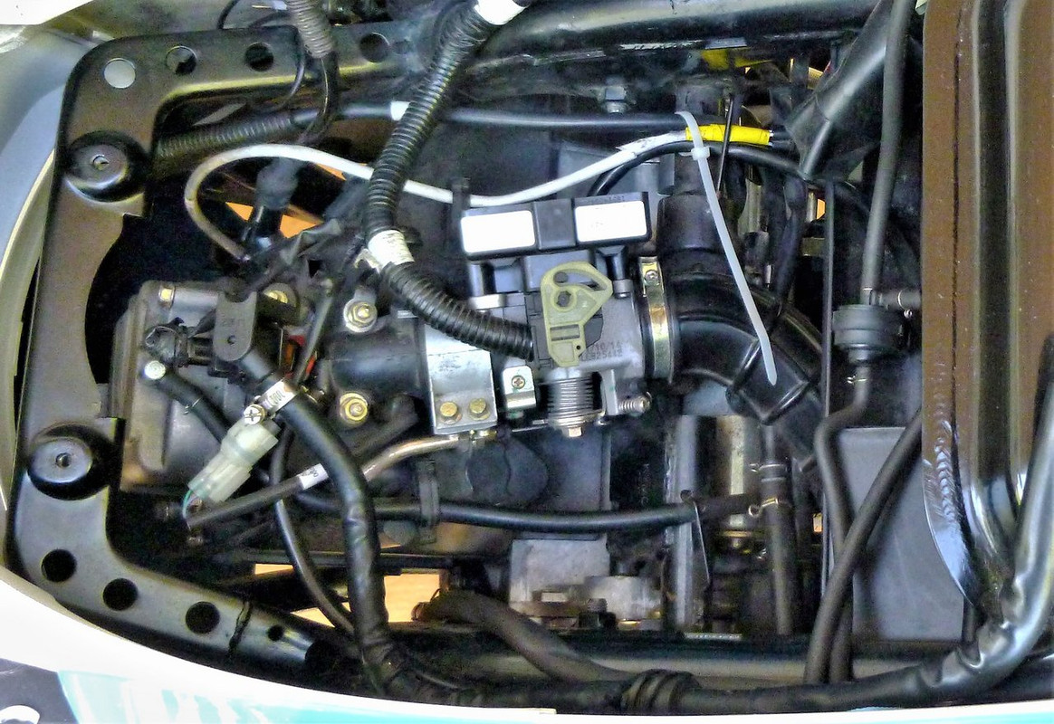

Yes I have photos but not sure how to share them on here. He said he checked the fuses but somethings look a little weird over by the battery now that I'm looking at it.
Re: Like 200i not starting
« Reply #8 on: June 11, 2020, 07:57:23 PM »
OK, your hose with the wire clip on it goes from the valve cover, under a plastic clip, then under a wire clip and makes that (built-in) right turn to fasten just under the fatter hose in the photo..
You can just see your clip showing under that fat hose....just below the golden colored starter cyclinder.  There is a place to plug your hose into there.
Hopefully....I'm working off some old photos of my engine bay.
Let me know if that's not working for you.
Maybe one hose down now, yes?

Hello Renee, I think I might know where the other hose connects. Look on your old "carb" and see if it has the circled inlet port. The older throttle bodies had this port to connect the evap cannister to the incoming air from the filter. The newer replacements do not . If it has the fitting your mystery hose connects to it. If you don't have the fitting just vent the evap hose to the ground and zip tie it in place.  I had this issue when I replaced my throttle body a few years back and the guys at Kymco USA told be to just vent the the hose. As to the code problem it could be that your battery is just kaput!
