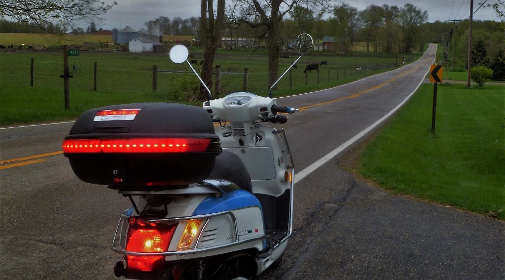

Every one of my scooter rides involves some riding in the dark.
One thing which drew me to the Kymco LIKE was the large tail light!
I replaced the case with one that has wrap-around LED running lights - which double in number when braking.
That's I-70 over there to the left.

Do you draw the voltage from the rear tail light assembly?
Yes, wired into the rear light assemble.
Lay on your back and remove the little panel to expose the wires and all the rear bulb holders.
Being all-LEDs, the drain is not significant.
Photo hoster took away all my install pix - but I added a sticky, above,  of the procedure.
Routed wires to the assembly into the body, here

Stig / Major Tom, what method did you use to tap into the wires for power to your top box? Solder with heat shrink? posi taps?
Re: Rear lighting LIKE200iLX
« Reply #7 on: May 29, 2020, 03:05:55 PM »
To make certain I was tapping into the correct wires - I worked upside-down in that tail light assembly - rather than digging into the wiring harness elsewhere. Tight quarters - I used something like posi taps. The area is well sealed behind that removable flap/panel, and I've had not trouble with my connections.
